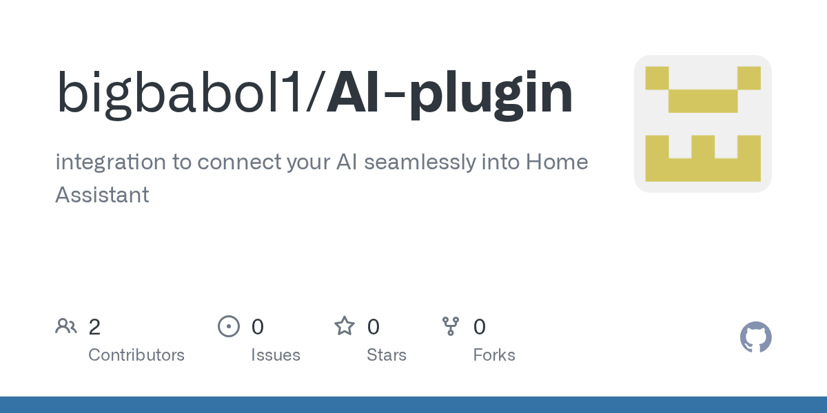

  1. AI Plugin: an Assist conversation agent
- Common commands (time, sensors, on/off, covers, volume) skip the LLM and answer in about 0.05 s.
- It streams replies, so speech starts after the first sentence, and its prompt layout keeps Ollama’s prefix cache warm.
- If the model claims an action it never took, it gets one corrective re-run.
- It also has voice timers, memory, web search, MCP servers, an ai_task entity and 6 languages.
- Best model I found for 8 GB: gemma-4-12B-it UD-Q3_K_XL. It scored 100% on my tool calling tests with a ~3.6 s median. qwen3.5:9b is faster at ~2.9 s.
- I’ve only tested it with Ollama. Reports from other backends are welcome.

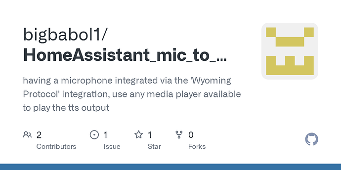

2. Mic to MediaPlayer: any satellite as the mic, any media player as the speaker
- Works with Wyoming, ESPHome, the companion app and VoIP satellites.
- Replies play on your Sonos, Cast or DLNA speakers.
- Its announce service pauses music and resumes it afterwards.
- Follow-up listening still works.
- With both installed, AI Plugin filters out the satellite hearing its own reply, so it doesn’t loop.
You wrote a about 6 languages. Which ones are they? In my case I need Dutch.
Hi, I chose German, English, Spanish, French, Polish and Portuguese. Adding another language is easy. Just add the language file as a YAML PR (i18n/CONTRIBUTING.md).
Anyway, I added a Dutch translation now :slight_smile:
Thank you for your work.
I’m happy to contribute. Let me know if there is anything else that needs to be added/tuned :slight_smile:
