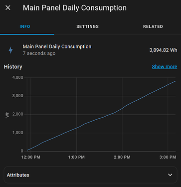

I’ve let the accumulation run all day and this is the comparison:
Old sensor:
8 MILLION Wh?
vs.
Reimann Sum helper:
3kWh
My expected daily usage is somewhere around 20kWh +/- 10% and it’s a quiet cool day, so this feels more correct. I’m going to switch out the utility meter to use the new accumulator this evening if it pans out…
