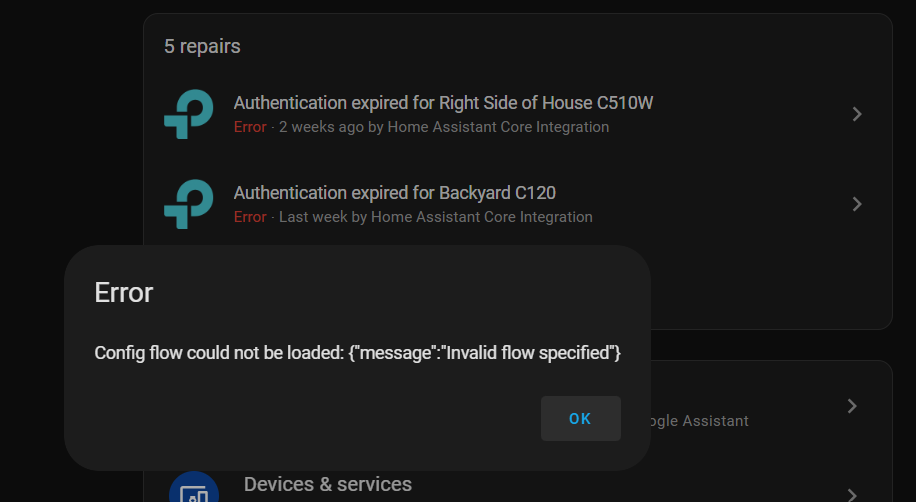

So I am still getting these TP-Link issues on a daily basis but it seems to authenticate just fine? Why is this a daily occurrence?
Looks like an expiration issue? Anyone have a fix?
Thank you, this did it for me in the KASA app.
Still getting some strange behavior though all cameras are working just fine in HA so not sure what is causing these to stay:
