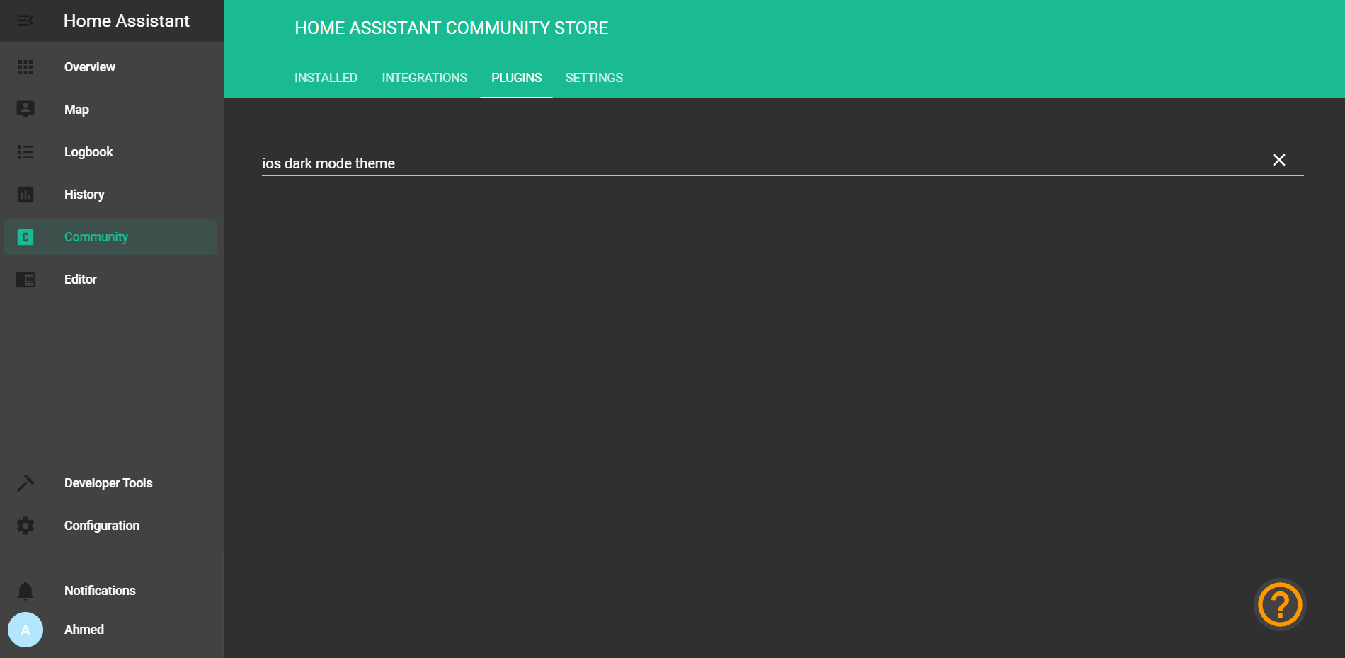

Hello @basnijholt thanks for this, I cannot find it in HACS? are you sure its available?
I am happy that you guys like it! Leave a star
on the repo
@bachoo786, definitely! Search for “iOS Dark Mode Theme”.
@basnijholt I cannot find it . See below
Make sure you’ve enabled themes in HACS:
It’s in a new tab after adding, and a restart of HA:
You might also need this somewhere:
I have it but I can’t remember if it’s required…

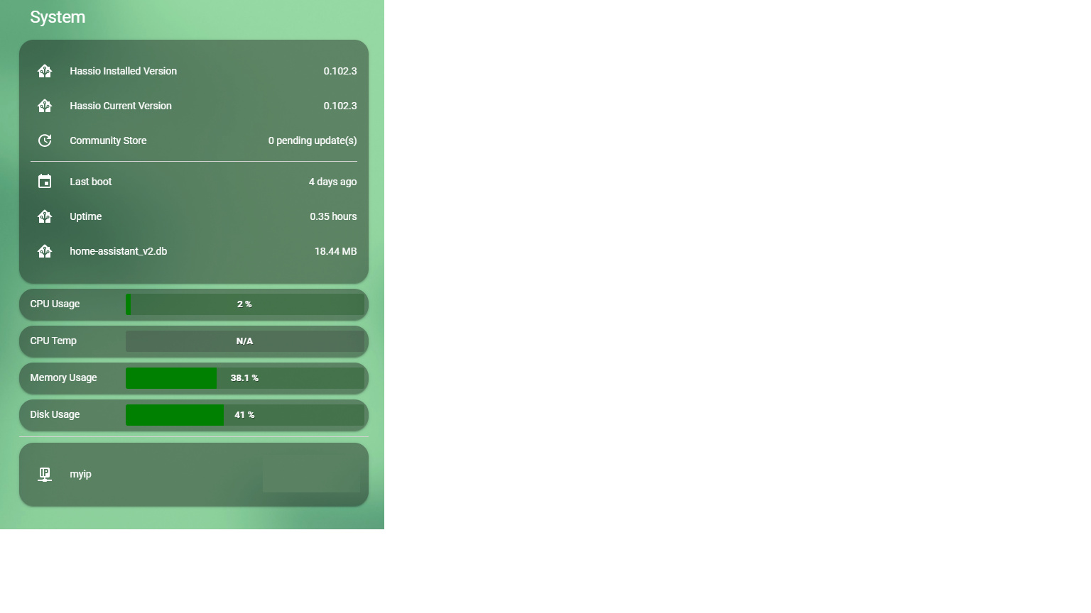

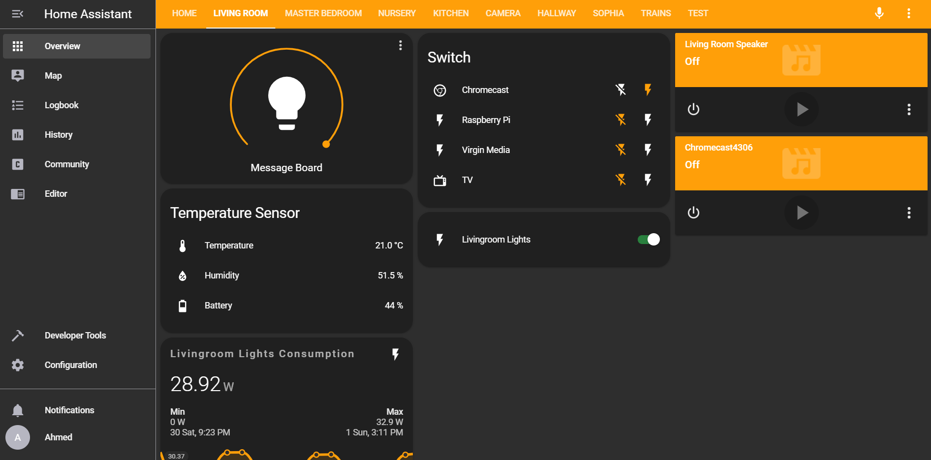

hey @keithcroshaw just wondering why is it that my theme is all orange and the one on the screenshots looks green?
here is mine i.e ios-dark-mode:
I think you need to go to edit lovelace and then select “Raw config editor”
Then paste this line in the top:
background: var(--background-image)
Do you have this somewhere in your configuration.yaml?
I think this grabs the HACS themes so you don’t have to manage them yourself.
When I was doing it manually they were all in their own files and combined via this method anyway.
I called mine Themes though, which messed things up. Needed to be themes.
All is case sensitive in this world…
thanks @keithcroshaw
that done it but I still have the orange bits. How can I get rid of them?
primary-color: rgba(153, 159, 153, 1)
Works for me
Oh and you’ll need to restart HA after making the change. UGH I know right…
