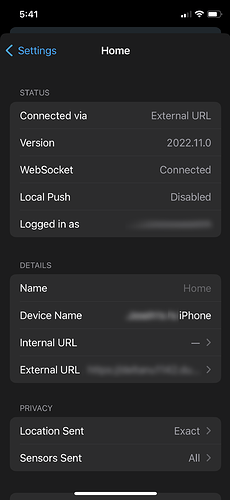

I have only one server in the Companion app. Location Accuracy is set to “Full.” Screen shots are above. I even toggled “Precise Location” in the iPhone privacy settings after initial startup (“off” doesn’t allow the app to update location). I don’t know what else to try. I’m prepared to roll back to baseline at any time, but I’ve run out of ideas as to where to go from there. There was a comment on one thread that this might be caused by the “Use Zone Name” setting in the app, under Sensors —> Geocoded Location. I’ve toggled that and rebooted, updated location… nothing. I appreciate your willingness to respond, as I’m getting no other help on this. I’ve dug deep in these forums for a solution, and I’m hitting slabs of granite.

All of the sensors (e.g. geocode) should be unrelated to the device_tracker as that’s updated entirely separately from sensors. The privacy setting I’d like you to check is in the app’s settings > [Your Server] > at the bottom, what is the value set to “Location Sent” under Privacy there?

OK, with this in mind I just installed the app on my iPhone. I know I didn’t answer this earlier, but as far as I can tell, it’s always been set to “Exact”. This is how it appeared when I installed the app:
