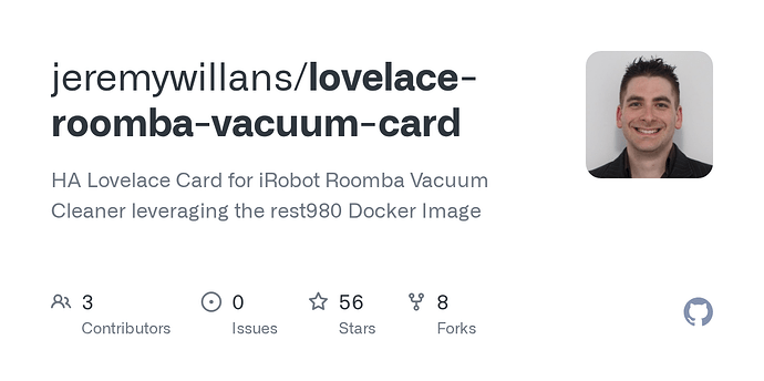

HA Configurations
Lovelace Roomba Card
HA Addons (formerly Hass.io Addons)
Lovelace Example

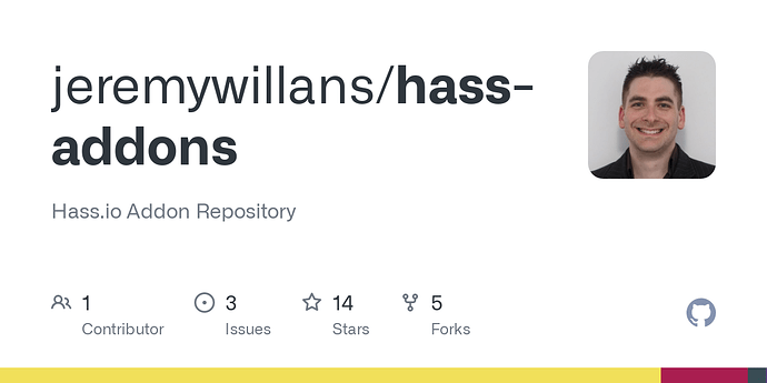

@chansearrington - I did some investigating and I have found and verified a way to run the Rest980 image in Hass.io :slight_smile:
I have created a custom Hass.io Add-on Repo (you will need to add as a custom repository) which contains an add-on which will install this image.
In order to get the BLID/Password, refer here for help

Yeah you will need to add the github repo as a custom repository and it should come up.
