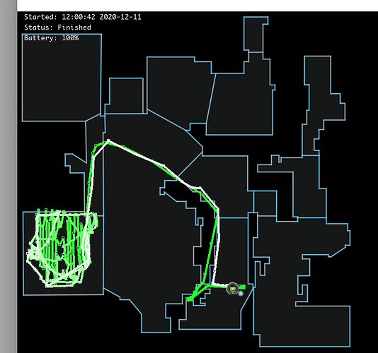

2.I don’t have the map generating part down. Can the xxx.xxx.xxx.xxx:/images.php only generate the “latest.png” only after a clean? I was under the impression that I can delete latest.png and then call the images.php. Once I delete the latest.png I get PHP errors till another clean cycle is run. What am I missing?

this should be image.php
it only generates the latest.png when the path is appended with ?last=true which calls a specific function in the PHP file to create the latest.png
The idea of this is that the php file continually renders the map live dyring the clean (as camera.roomba points to this image.php file). once the clean is done, there is an automation to call the ?last=true which create the png file.
also in the php file is a function that checks if a latest.png file exists and if so → only putput that file and not continue to render the map when a clean is not in progress.
when a clean first start, it invokes the php file with ?clear=true which deletes the latest.php file so the map is rendered each refresh.

Now I am trying to figure out how to scale the overlay and the lines to fit.

How do I get the floor.png do reflect my actual floor? I don’t know how to adjusted the image it generated. I used the app to do a clean on the master bedroom and got the map like below.
Do I need to do a full clean? The last time I did a full clean which took 7.5 hours due to two charges in between, though the total clean area is only about 1000 sq ft.
I started with screenshots from the iRobot app. Then I imported them into fusion360 and used the calibrate to get them the right size, then outlined those for my floor. Then it took a lot of trial and error to get the size right and offsets.
Then as I ran it for different rooms, I would save the vacuum.log to that room. Then once you have a sample, then you can rename it back and let it build a new image. You do have to delete the last.png for it to build a new one. Still not there.
Here is the run for the master bedroom, bath, and closet.
Here is the living room, kitchen, behind the couch, and bar area.
This is what we call the grandkids room because that is where they stay when visiting.
Then last here is the kids, just like grandkids, really a guest room so the kids stay there when visiting.
All those screenshots above were made from saved runs. You can see I need to tweak some lines in the floor.png but also it close enough to get a good feeling for what happening.
