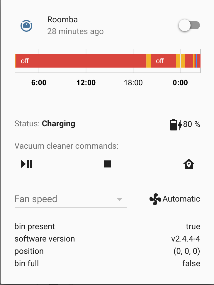

1 year after… Has anyone been able to get the map into HA? ^^
nope, but I just export the position coordinates to a file via automation and setup a generic camera fetching a php script which returns a generated image and draws rectangles/lines on the coordinates.
It’s far from perfect but gets the job done :slight_smile:

Thank’s! Is it possible to have also the php script and all resources or the github repository if exist? I will try this method =)
sorry I don’t have a repo for this but you can download the code here:
https://gitlab.com/uploads/-/system/personal_snippet/1927224/47310dbe41a015d8daf0dd807bee8ec4/roomba.zip
I made some refinements so it looks nicer
Thank you very much! I will test it and tell you :slight_smile:
