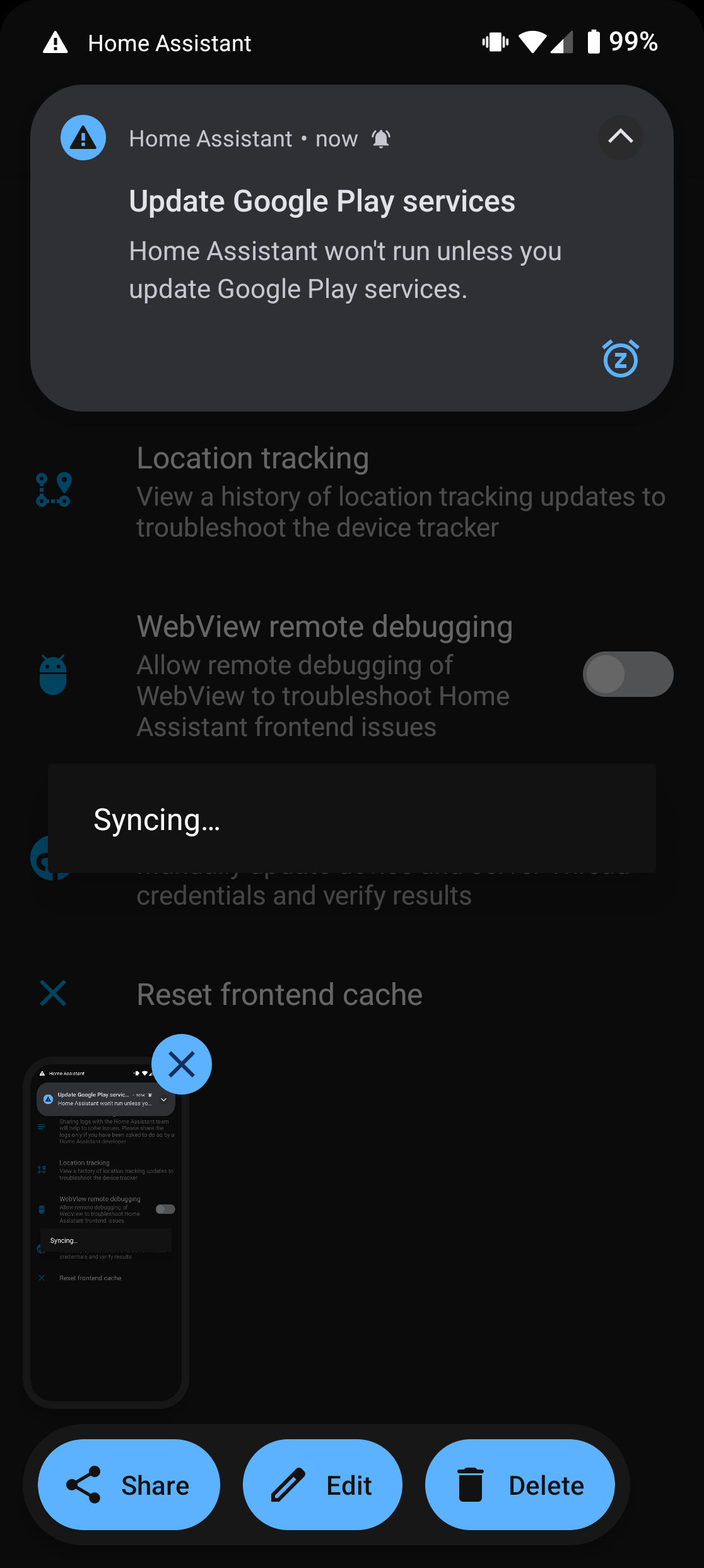

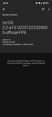

I use a AOSP (Open ROM) on my phone. So that i do not have to use google or apple on my phone. I really try to make sure no company as there paws inside my network / home.
Which is also why I use home assistant
I’m conscious about picking only the hardware that is open and fully mine, no cloud, no internet, only local.
I though matter would be that as well, but it seems I need google services just to be able to add thread to my phone? (Let alone adding devices)

The reason why you need google services is because you use a Android phone to commission the Matter device.
The way the commission work is that the Phone makes a new Matter fabric and joins the device to that, then it shares that fabric with HA, which joins it with the Matter fabric it has.
iPhones do the same with an Apple Matter fabric.
But there is an option to also plug in a BT radio dedicated to the Matter server in the HA server and use that to set up the device instead, which does not require those Google and Apple services.
I think it is done from the Matter Server’s web interface.
