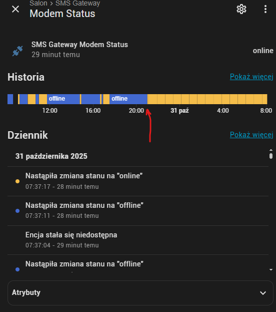

Unfortunately with my modem:
there is constant problem with offline status :frowning: :
With arrow I marked moment in which I started using an automation to restart addon after “offline” status. Here are logs:

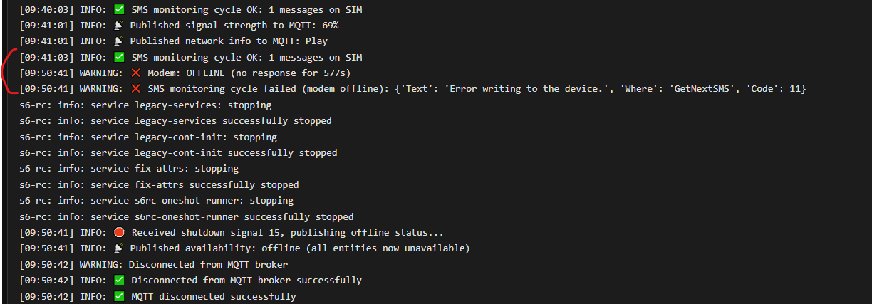

Could you please add an option to set logger level to debug? Now the addon is starting with Debug mode: off (as seen in logs)
The offline status is only informational and doesn’t affect functionality, so you can safely ignore it. I’m still testing this feature — it’s sometimes tricky to detect the connection state reliably. I tested it with a one-minute read interval, and it worked so that if data wasn’t read from the modem twice in a row, the status switched to offline. As soon as data is read again, it goes back online.
Did the addon stop by itself? It shouldn’t do that. In previous versions, the offline status detection wasn’t really working, so it may have seemed fine before.
The debug mode was left there from development for troubleshooting. There should already be enough log messages even without debug mode. The log shows a problem with reading from the device.
Try reducing the read interval to 60 seconds and see if that improves stability. I haven’t fully tested longer intervals yet.

[08:19:49] WARNING: ❌ Modem: OFFLINE (no response for 519s)
[08:19:49] WARNING: ❌ SMS monitoring cycle failed (modem offline): {'Text': 'Error writing to the device.', 'Where': 'GetNextSMS', 'Code': 11}
As you can see offline status does affect functionality - it causes monitoring cycle failure :frowning: BEfore I’ve implemented addon restart it couldn’t properly monitor SMS after modem going offline. So I think that it’s “real” offline (error message states write problem)
Addon doesn’t stop by itself. I restart it after offline status event.
The cycle is already at 60 seconds. I haven’t changed default value
