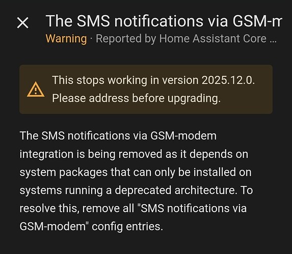

I get the following error:
Thanks!
It seems to be deprecated. Unfortunately, I bought the SIM800 modem specifically for this.
Home Assistant shows me this after the current update
Is there an alternative? I would like to have the local modem, since it does not rely on an active internet connection.
