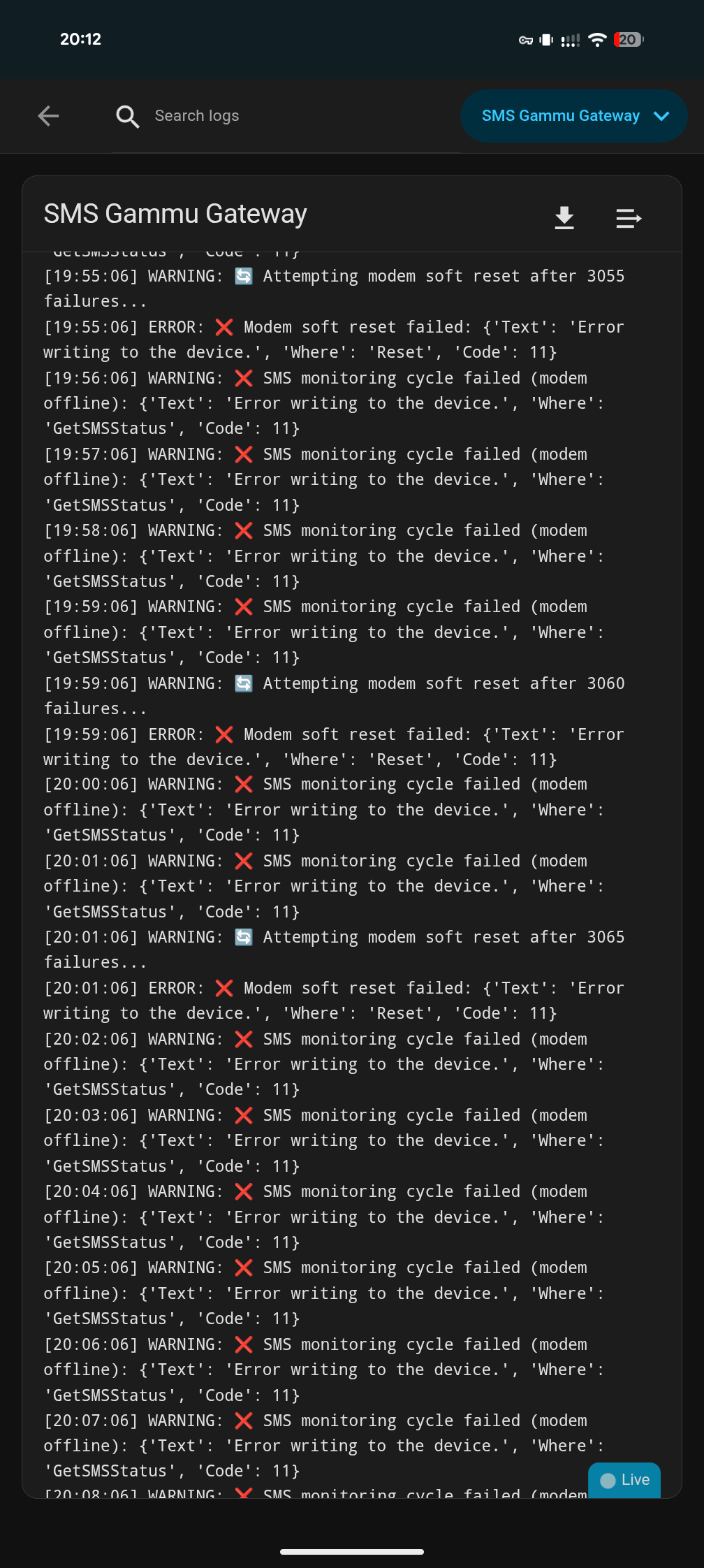

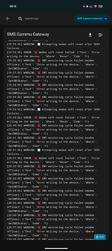

It did it again… It runs for a good few days and then the modem just goes offline and needs a system reboot to bring it back.
Startup log below.
Thanks

Thanks for the detailed analysis — this is very likely pointing to the root cause.
One important thing that stands out is the USB interface you’re currently using:
/dev/serial/by-id/usb-SIMCom_...-if04-port0
On SIMCom A76xx / A7670 modems, the device exposes multiple USB serial interfaces, each with a different purpose:
  • if00 / if01 / if02 / if03 → AT command & modem control ports
  • if04 → GNSS / NMEA / diagnostic port
The if04 interface is not intended for AT command traffic or SMS handling and is known to be less stable for continuous polling. Using it for Gammu (especially with regular GetSMSStatus checks) can lead to exactly the behavior you’re seeing: the modem appears offline and eventually stops responding to writes.
Recommendation
I would strongly suggest trying a different interface, ideally one of the AT ports:
/dev/serial/by-id/usb-SIMCom_...-if02-port0
or
/dev/serial/by-id/usb-SIMCom_...-if03-port0
You can list all available interfaces with:
ls -la /dev/serial/by-id/*A76XX*
Then update the configuration to use one of the AT ports instead of if04.
Why this matters
  • The GNSS/NMEA interface (if04) may suspend or stop responding
  • AT ports are designed for stable, long-running command sessions
  • Switching to the correct port often resolves random “modem offline” and write errors without any other changes
If the issue persists after switching ports, the next thing to look at would be USB power management (autosuspend), but based on the device path alone, the port selection is already a likely cause.
