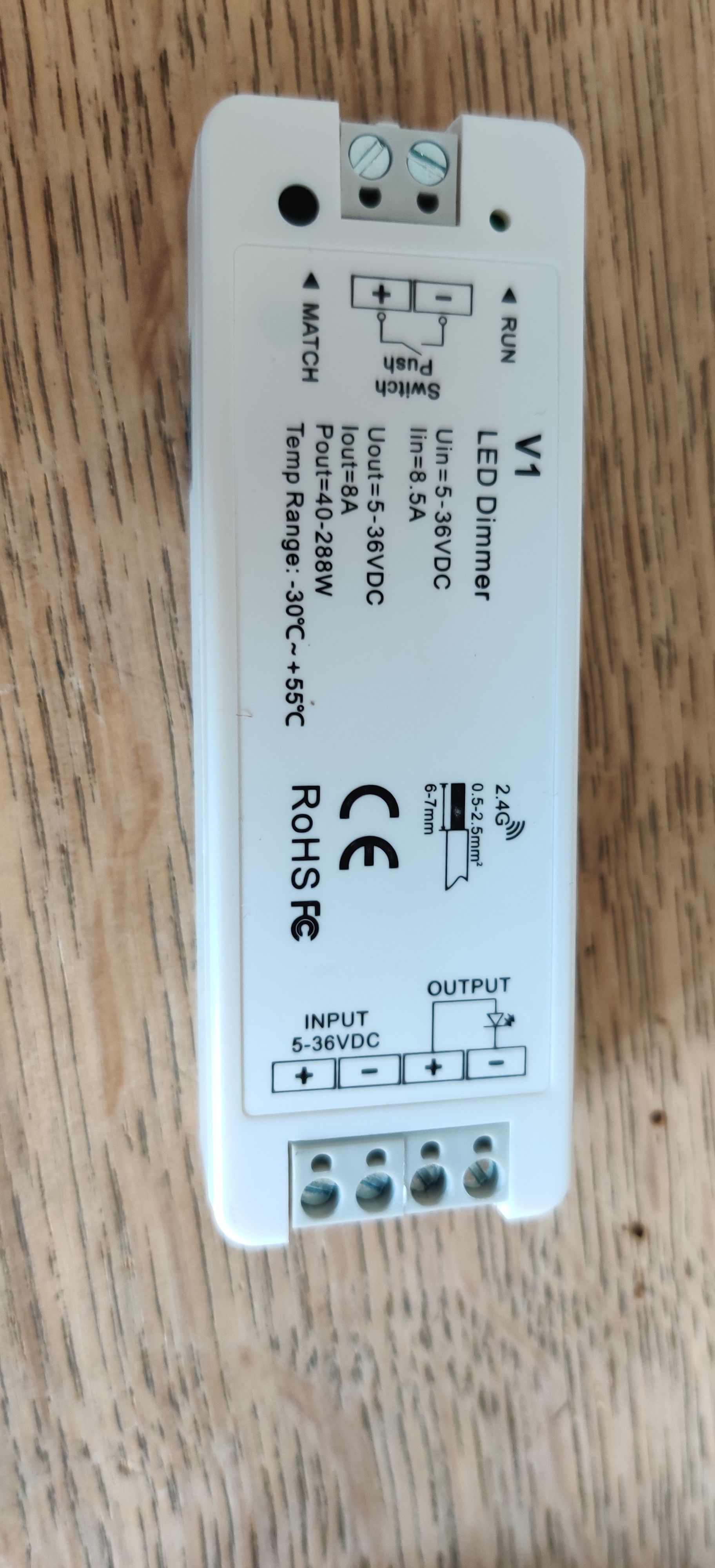

Zigbee, Bluetooth, Wifi, MiLight are all using 2.4 Ghz band. It might be difficult to identify the protocol with only the remote picture. Does the controller present additional information?
I think you’re right that is not a MiLight unit (although have seen some cases completely different from the original remotes, usually they have discrete buttons for on and off - which are needed for pairing).
Thank you for the info, the only problem is that I think this remote is not using any of those protocols. I’ll try to find some more information about the remote and post it here.
Edit:
Here’s the link with more info

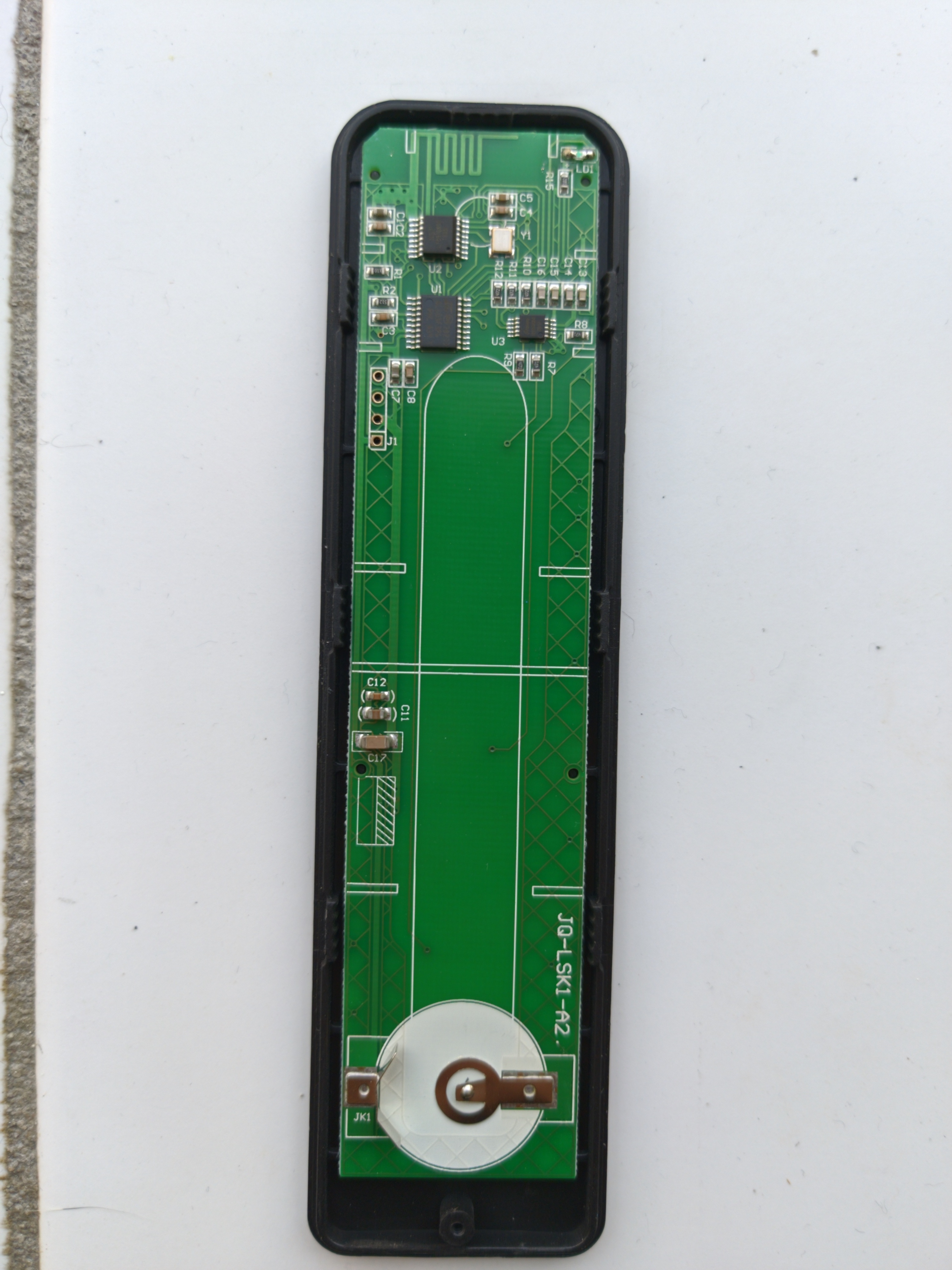

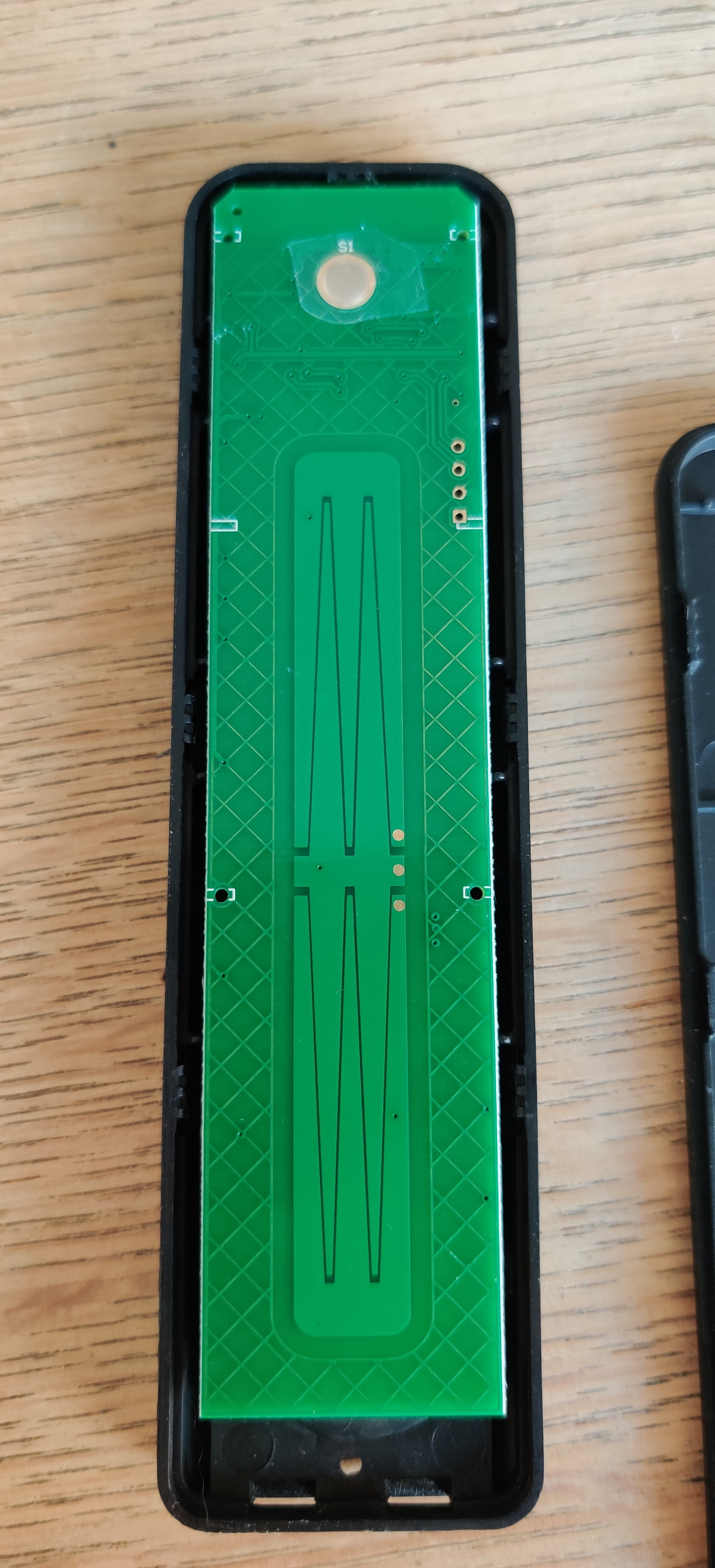

There is no esp-chip inside. Here are some pictures of the inside:
The first photo is the “button and capacitive touch” side, the second and third photo are the back of the board (where the battery, CR2032, is located).

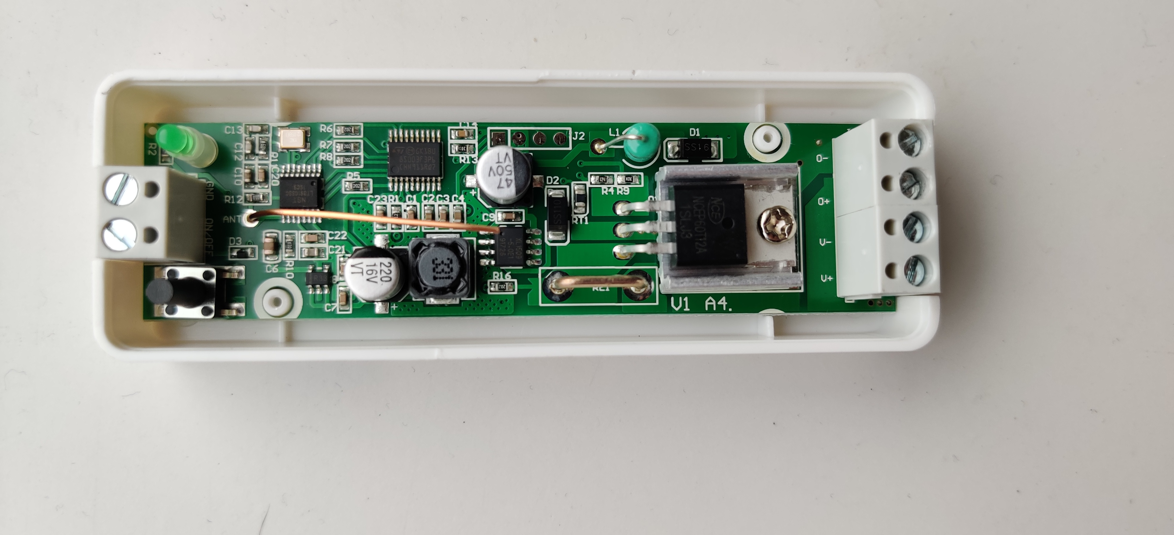

added photos of the receiver module:
Looks like the LT8910SSC is the wifi chip they’re using.
It is probably from the same garden variety as MiLight (also uses LT8900/PL1167 chipset) with a different encryption scheme.
Unfortunately, it is likely quite difficult to add support for the dozens of such protocols if not wide-spread or someone has not yet started analyzing it.
See, for example, RE for MiLight
Likely easier just to build your own RGBW controller at that point.
WLED on an ESP board would indeed be easier.
