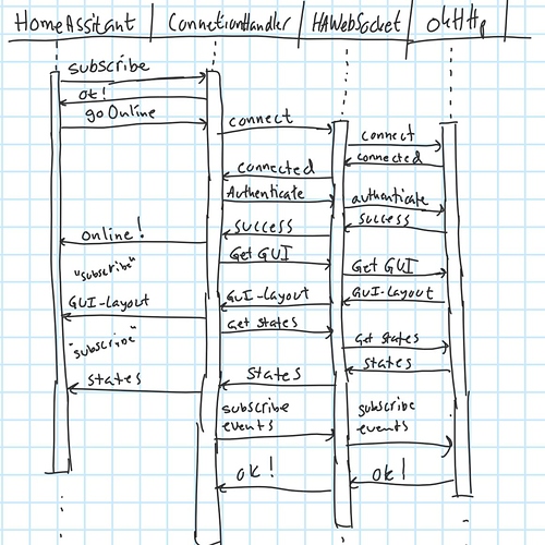

I have created some sketches on how i would like to design the application:
My handwriting can be tricky to read sometimes :stuck_out_tongue:
The first one is how threads communicate:
Here is a class diagram:
Here is a use-case diagram:
Looking forward to see some of your pictures. :slight_smile:
