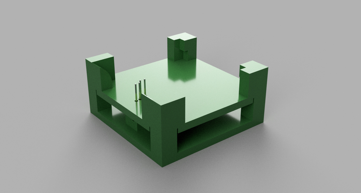

My favorite option for getting custom firmware on the Mini is using my custom 3D printed programming jig and pogo pins. I have published the 3D print files on thingiverse for anyone else who would like to try it. This method allows you to directly flash new firmware without ever connecting the Sonoff Mini to Sonoff servers in China and will allow you to flash firmware up to 1 MB in size instead of the 508KB OTA limit.!
