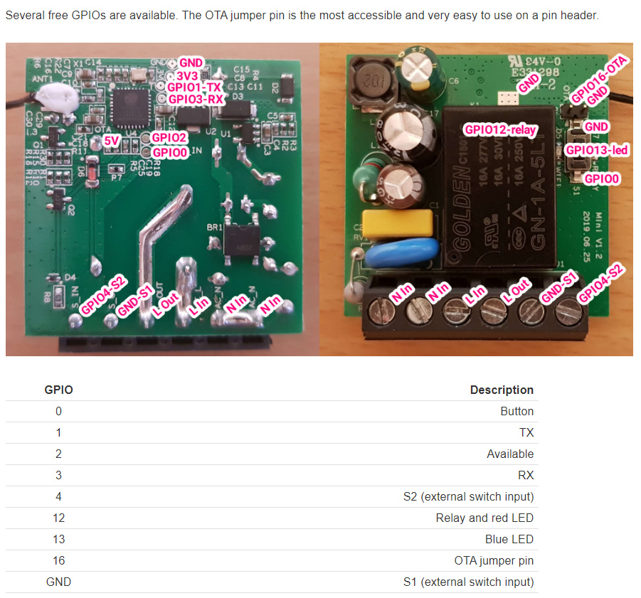

Did you continue to investigate this? I wanted an extra input to the mini so just used the OTA pin header. Once flashed with ESPhome, this pin is available as GPIO 16, well I think so, I’m about to try it. That header pin is way easier to break out than soldering directly to the board.
I did not test myself, but others have.
I would agree using the DIY pin (GPIO16) will be the easiest and is what I plan as well.
On the Tasmota Template page, someone added what I have found to be the best explanation so far:
