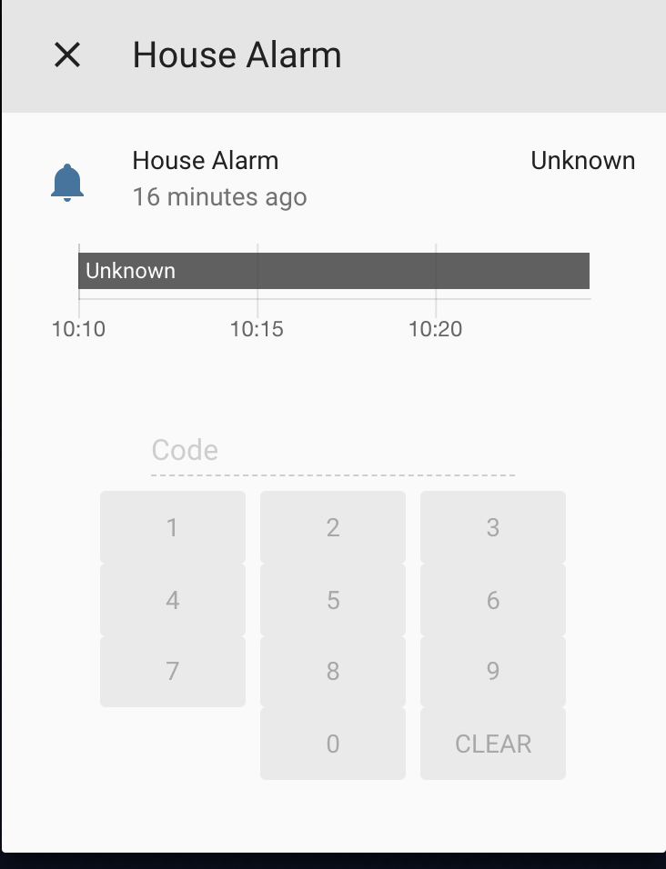

I thought I would try to use IFTTT, but just get this:
The code is unclickable as well. Here is my yaml:
alarm_control_panel:
- platform: ifttt
code: 1234
event_arm_away: AlarmOn
event_arm_home: alarm_home
event_disarm: AlarmOff
optimistic: true
The events are the trigger words in the IFTTT Webhooks - is that correct? or do I need the full URLs?

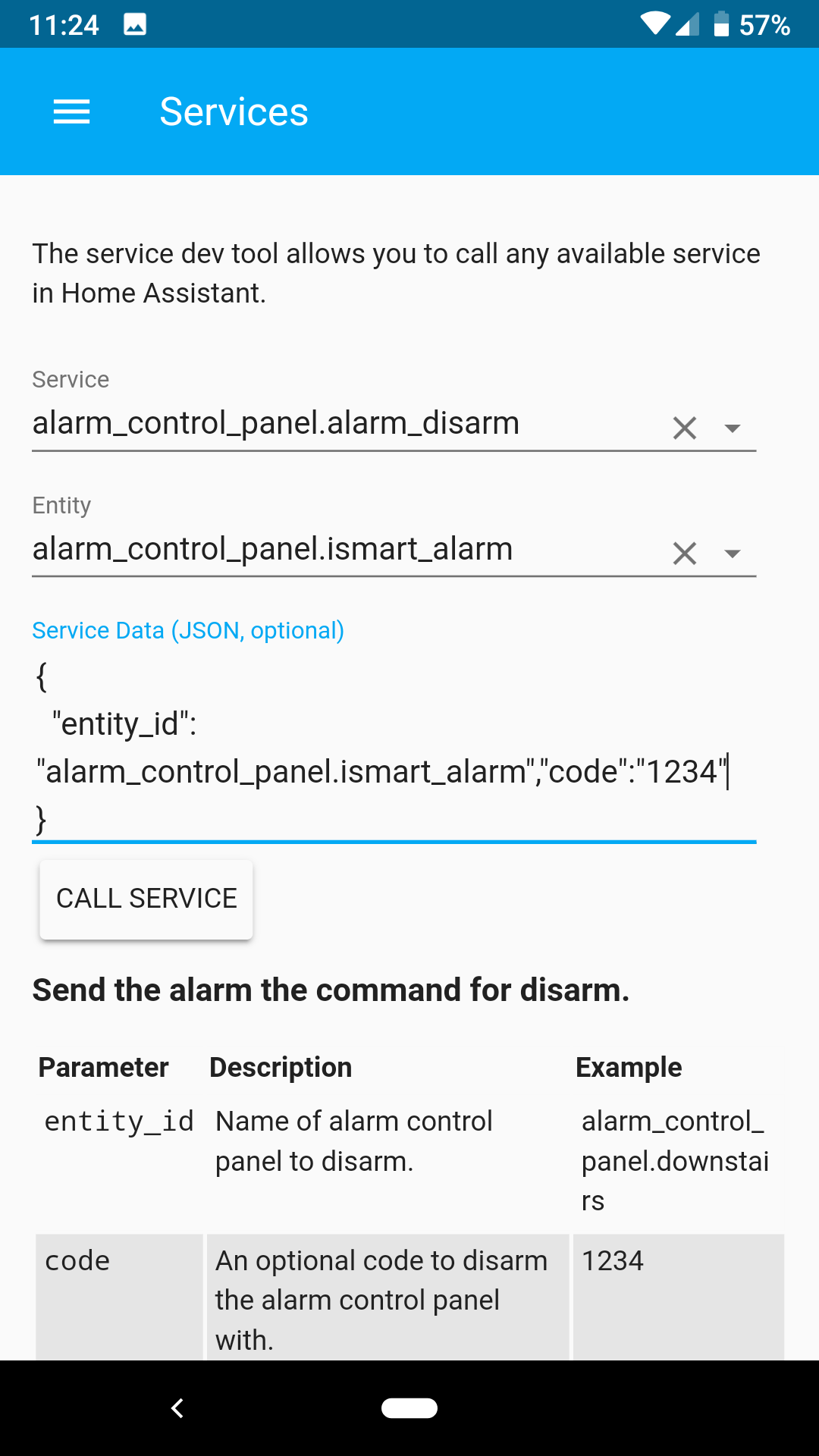

This I what I get too upon first adding it. To resolve use the HASS services to update the status and the panel will become active.
This get pretty annoying cause it happens on every reboot of Hass. To resolve I’ve an automation to save the status and restore it after reboot.
