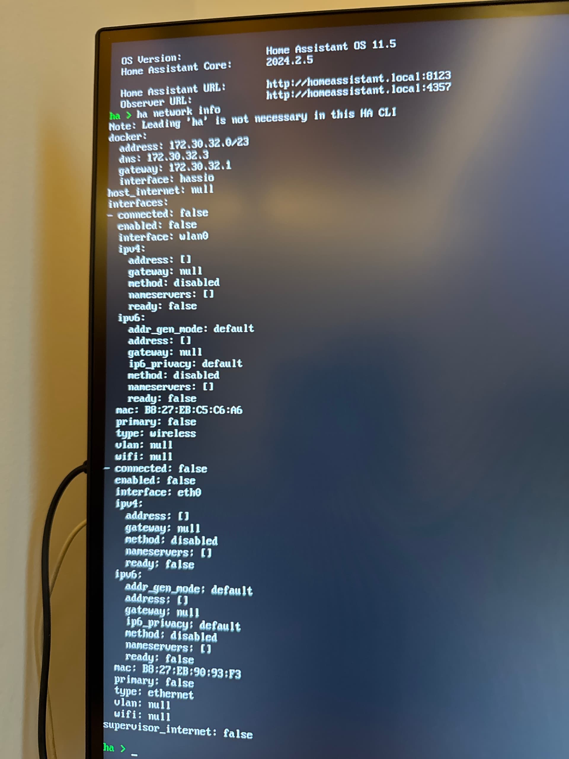

Good morning everyone, I have been using Home Assistant on a Raspberry for years. Recently a storm damaged some devices in the house, in particular I noticed the whole HA system no longer worked, the ethernet avo when connected does not turn on the Raspberry lights so I think the card is damaged. The system starts and shows this screen. At ChatGPT’s suggestion I uploaded a .nmconnection file with the wifi network but even then it does not connect to the internet.
The first question is, even without internet the whole zigbee part should work and yet it is not active. I also ask if there is some way to restore or lose as little as possible of the settings, before I performed the backup with the google drive extension. Do you recommend a new installation from scratch? Is there no way to recover from the microsd what I need?
