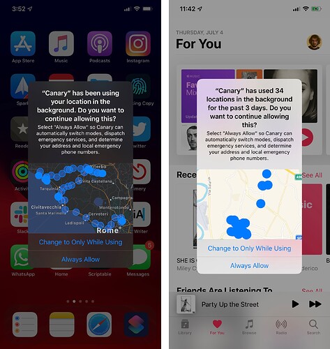

That will definitely do it. Low power mode won’t affect location tracking. You’ll want to teach them to choose “Always” when the system inevitably prompts to confirm the setting. It looks something like this:
(via this old MacStories review of iOS 13 so it’s slightly different now – I believe “change to…” is bold.)
Yes, I also get them. I’n already happy I finally convinced them to keel killing apps that use geolocation. On to the next challenge :smirk:
