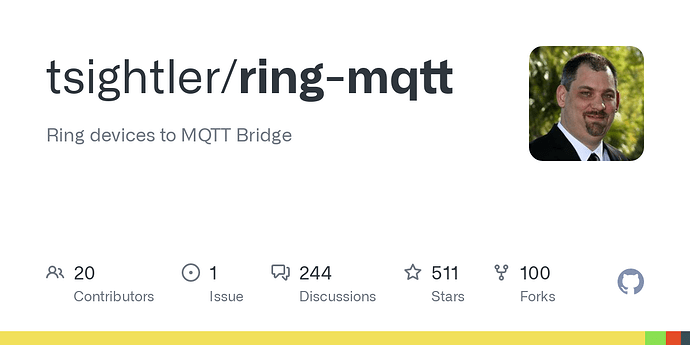

Thank you! I will start exploring and getting RingMQTT installed in home assistant. I am sure I will need some assistance!
Is this one the one I want to get?
Well I got it installed a mostly working! Trying to figure out the option to display the motion of the last video. I thought I could do that but must not have the right entity or something else needs to be configured.
congrats. now you not only have last video, but you have the ability to show live video too… need help getting the last video? if so, post what you did to get/show it using the ring integration and maybe we can remap it for the new one.
