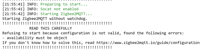

The issue is that Z"M is not starting. I am getting this error message.

Here is the config file. I hope i have redact the important parts…

Change the last line to:
availability:
  enabled: true
  active:
    timeout: 10
  passive:
    timeout: 1500
Or f you don’t want devices to be marked as unavailable when they stop transmitting on the network:
availability:
  enabled: false
Then restart z2m.
It worked. Thanks for the support.
