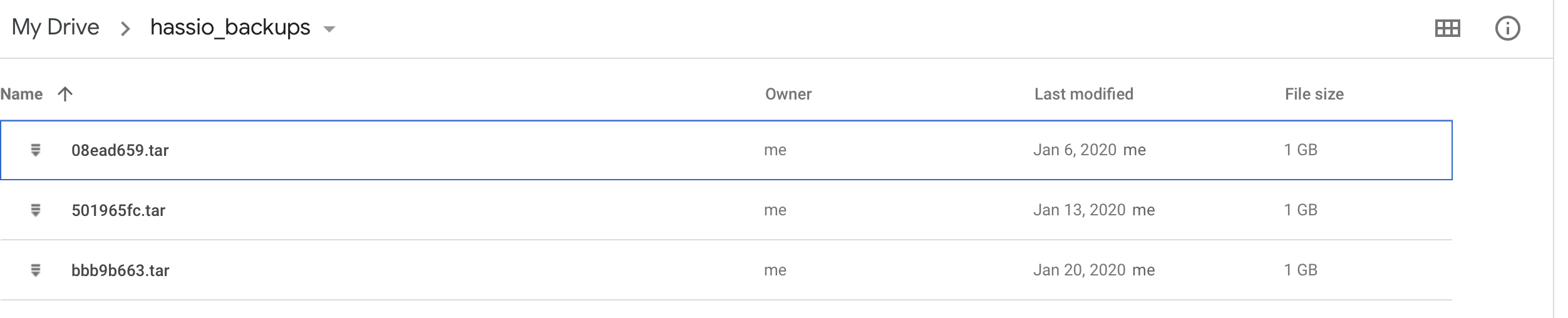

I set up google drive back up 6 months ago and have not touched it. This was a prompt for me to check and to my great and pleasant surprise
