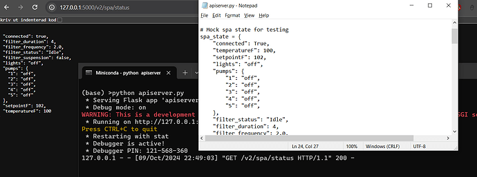

Quick Flask server mockup, will test in HA tomorrow
And testserver works
