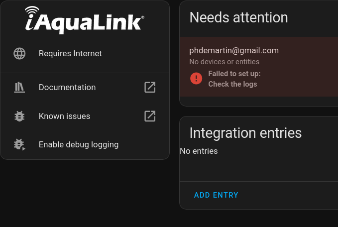

I’ve got a robot Zodiac Alpha OA 6400 IQ, but the integration display this message
No devices or entities
Failed to set up:
Check the logs
And the log:
Logger: homeassistant.components.iaqualink
Source: components/iaqualink/__init__.py:89
integration: Jandy iAqualink ([documentation](https://www.home-assistant.io/integrations/iaqualink), [issues](https://github.com/home-assistant/core/issues?q=is%3Aissue+is%3Aopen+label%3A%22integration%3A+iaqualink%22))
First occurred: 1:34:40 PM (1 occurrences)
Last logged: 1:34:40 PM
No systems detected or supported
Logger: iaqualink
Source: components/iaqualink/__init__.py:80
vr is not a supported system type.
I can log into the webpage without a problem, and the iAqualinkapp is working as intended.
What is my problem

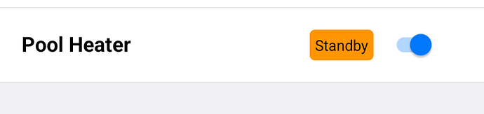

I have Jandy iAquaLink as well and I’d like to monitor when the Jandy Zodiac pool heater goes from On (standby) to actually On.
I have my heater thermostat set to 40 degrees, so it’s always in an On state, but status is Standby (not actually on).
My current automations are inadequate since they rely on entity going from off to on, or on state.
Is this possible for HA to pull / see the if in standby?

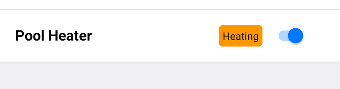

I want to circle back to my reply earlier, and see if anyone knows a way to identify when the Jandy Zodiac pool heater goes from on-standby mode to actually on?
I have the pool heater thermostat set to 40° and in the Jandy I aqualink app it shows as ‘On (standby)’. In home assistant The entity shows as On, curious if there’s a way to read when in standby or not…
As a result I’m not able to use automations to trigger when the heater is actually on versus in standby.
iAquaLink app statuses for On in Standby vs on and heating:
I’m wondering how I can create a custom template or automation to interpret the heater’s current state and determine if it’s in standby if the ‘standby’ attribute is not available…

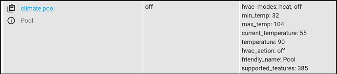

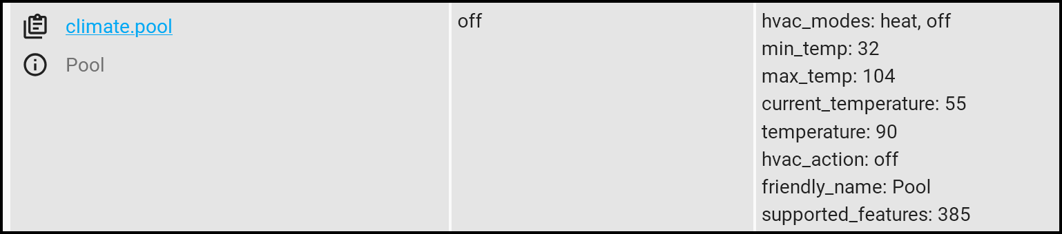

There is a parameter that has the status: hvac_action
It has the statuses of: off, heating, and idle
Hope that helps.
Are you referring to the statuses for the Jandy zodiac pool heater? Because I don’t see those statuses for that entity. I only see on and off. However if you’re referring to the workaround with the external zigbee temperature sensor, I’ll look for that when it arrives
It’s on the pool thermostat/climate entity.
Here’s a screenshot from the developer tools:
Interesting, I’m not sure how to find that or how to leverage it. I’ll dig into HA developer tools area to see if I can make sense… Any pointers?
