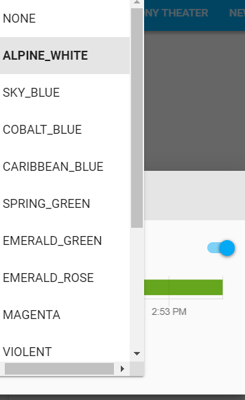

Did you implement support for the color lights? At least the one I sent you the mapping for?
I have support for color lights done on the API side. I think I still need the glue on the HA side. That shouldn’t be too complicated.

I’ve updated the master branch hass-aqualink repository to use the API. There should be some support for color lights now, although it is largely untested.

Changing lights doesn’t work. Gives an error of the following:
Sat May 04 2019 15:03:48 GMT-0400 (EDT)
‘devices_screen’
File “/usr/src/app/homeassistant/components/websocket_api/commands.py”, line 121, in handle_call_service
connection.context(msg))
File “/usr/src/app/homeassistant/core.py”, line 1138, in async_call
self._execute_service(handler, service_call))
File “/usr/src/app/homeassistant/core.py”, line 1160, in _execute_service
await handler.func(service_call)
File “/usr/src/app/homeassistant/components/light/init.py”, line 297, in async_handle_light_on_service
await light.async_turn_on(**pars)
File “/config/custom_components/aqualink/light.py”, line 63, in async_turn_on
await self.dev.set_effect(effect)
File “/config/deps/lib/python3.7/site-packages/iaqualink/device.py”, line 236, in set_effect
await self.system.set_light(data)
File “/config/deps/lib/python3.7/site-packages/iaqualink/system.py”, line 147, in set_light
await self._parse_devices_response®
File “/config/deps/lib/python3.7/site-packages/iaqualink/system.py”, line 111, in _parse_devices_response
if data[“devices_screen”][0][“status”] == “Offline”:
KeyError: ‘devices_screen’
