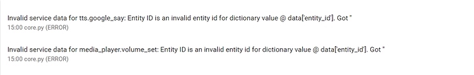

TTS does not work here. HA always return this error.
Figured out my issue. In the input_select.janet_notification_media_player I was adding the entity_id of my media player and not the correct friendly_name

You seem to be trying to specify * for the entity_id? That won’t work. If you need to specify all, just use a group with all teh media players/
