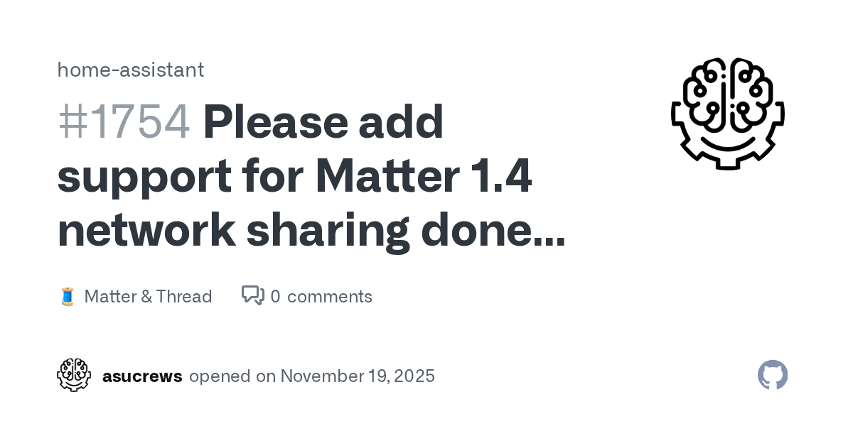

I did see this:
and
But they are both not solving the problem atm.
