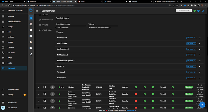

I had my BE469 working and my two BE469ZPs not working. Then, I changed to Z-Wave JS UI and now the inverse is true. The BE469 is now not working but both the BE469ZPs are working. No amount of healing or interviewing fixes this. It has to be the way Z-Wave is polling the devices for this information through this HACS integration.
BE469:
BE469ZP:
I even tried deleting the BE469 KeyMaster and re-adding it. This did not help.
Is the usercode command class showing up in ZwaveJS UI?
I do not see it for the BE469 but I see it for the BE469ZP:
BE469:
BE469ZP:
It’s actually the fact that Schlage is borderline out of spec for how they communicate on the wire and ZWaveJS/JSUI have to work around the locks.
For any lock where User Code is present - then clear the codes on the lock using the keymaster.clear code service and then go into the usercode section for the lock in question in JSUI and ensure every code slot you intend to use is either enabled or available. THEN go back to Keymaster and try to write the code. In my experience, once I have User Codes, then clear and reset the codes I’ve not had Keymaster barf on a lock.
For any lock where User Code is not present (your 469) - you’ll have to interview it until it shows up. There’s no way around it - Keymaster can’t interface with the codes if it can’t access them and they simply dont show as an option until this capability shows up. This may take a lot of repairs, pings, and various hoops. You may also have to use the checkbox in JSUI Settings > Zwave (bottom right corner under Zwave) to increase the node report timeout so it can interview correctly. (I had to do this for one of my 469’s)
