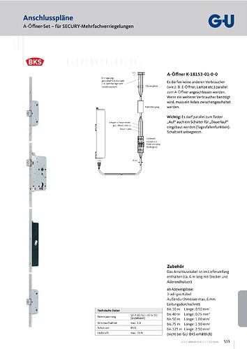

Hi @elvanja. Please could you share what motor you’re using for your door that’s controllable via HA? Thank you.

Unfortunately don’t have the exact model. It came with the door. All I got back from the manufacturer of the doors was this scheme. As far as I can tell, it is a german GU (company) model. Hope this helps.
