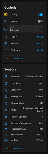

Moreover, the device running the kiosk application also offers several Home Assistant MQTT sensors, enhancing it’s functionality for automation purposes.

With the mqtt integration it is possible to turn the screen on via Home Assistant. The only thing required would be a Home Assistant automation and an existing presence or motion sensor. e.g when presence is detected, turn the screen on, turn off when no presence or after some timeout.
Additional the screen brightness may also be adjusted if the sensor provides some light (lux) measurements. e.g. dim the screen brightness down at night.
