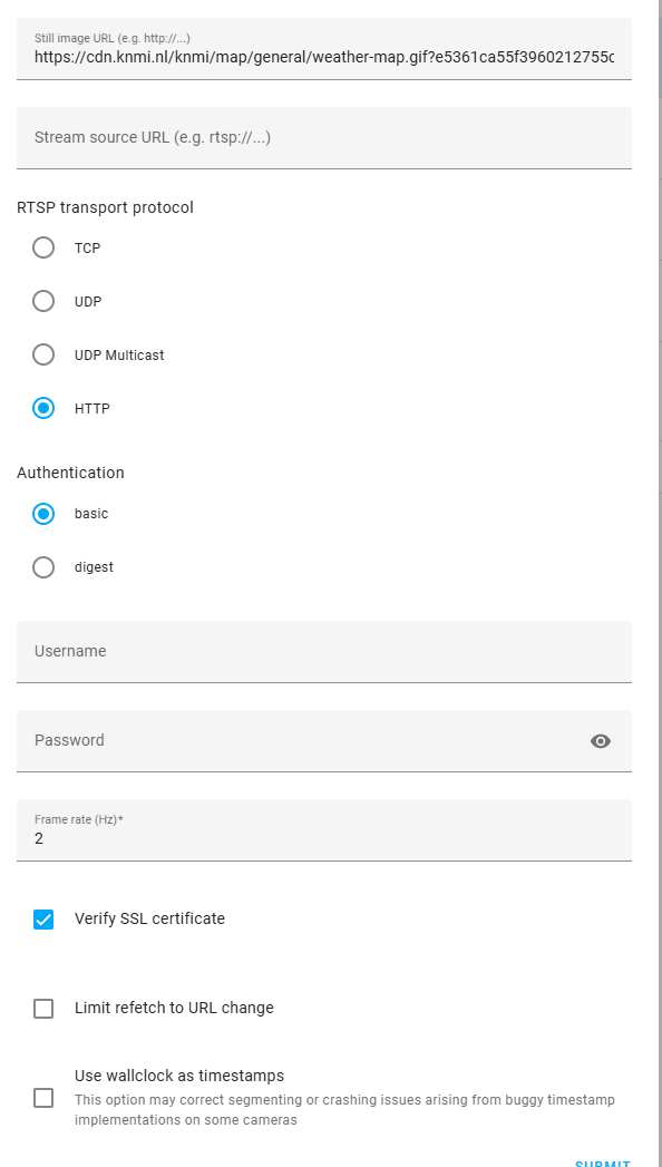

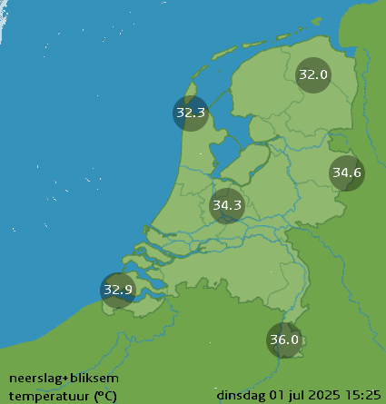

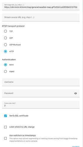

in regards to a ‘radar image’ on a dashboard. KNMI had for a short time their own animated image, but the feature of ‘prediction’ has been removed again. For now i just use an image card on my dash and a camera defined for url

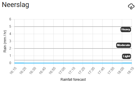

for prediction i use ‘neerslag’ custom card fed with buienalarm data
type: custom:neerslag-card
entity: sensor.neerslag_buienalarm_regen_data
title: Neerslag
