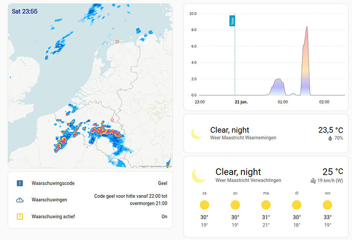

I would like to share a new weather integration for the Netherlands. I’ve dubbed it NL Weather. It’s using official KNMI sources to provide forecast, observations, radar forecast and weather warnings.

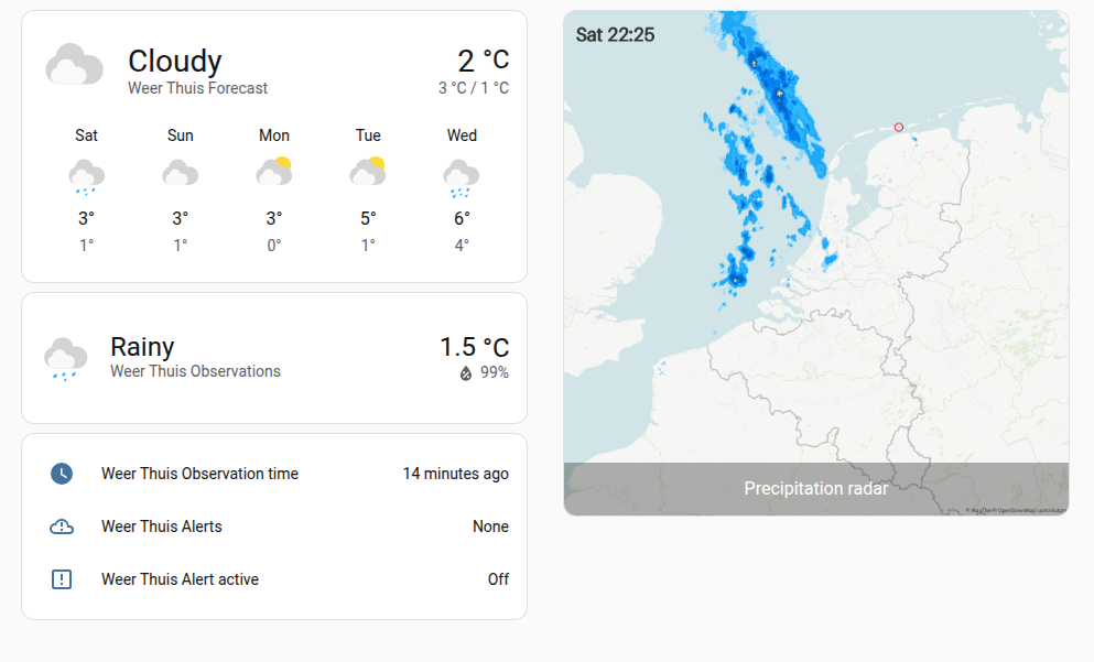

In this screenshot the custom card Weather Forecast Extended is used to display the forecast, warnings and observations. For the radar image the “Picture with entity” card is used.
Using default cards and radar in bright color theme
Entities provided
The integration provides two weather entities per location you configure. One entity is providing weather forecast up to a couple days ahead. The second entity is providing observation data from the closest official KNMI automatic weather station.
There is also a single camera entity which shows the precipitation radar images from one hour before, and up to two hours ahead in 10 minute time steps. This ‘movie’ is calculated by the integration from static images. This is a somewhat performance intensive step.
Finally, the integration provides several sensor per location providing several weather warning sensors and sensors related to the observation data.

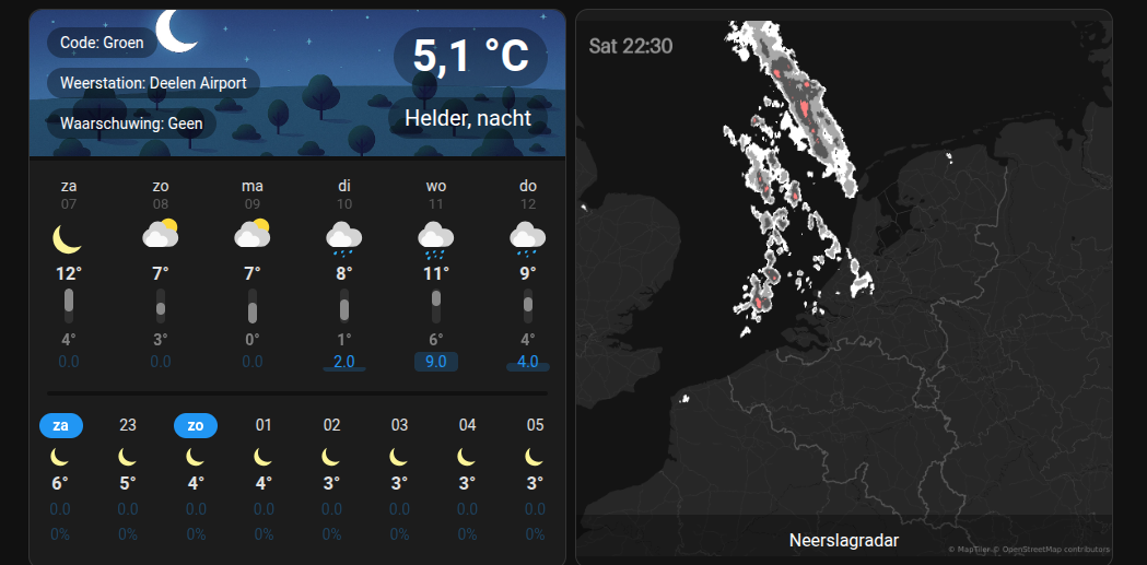

Thanx for your work! I was just searching for a alternative for buienradar. Always good to see another option. Though one thing i’m still looking for is a dark mode radar, any idea if this is possible in some way? When opening my dark mode dashboard this radar is absolutely blinding me lol.

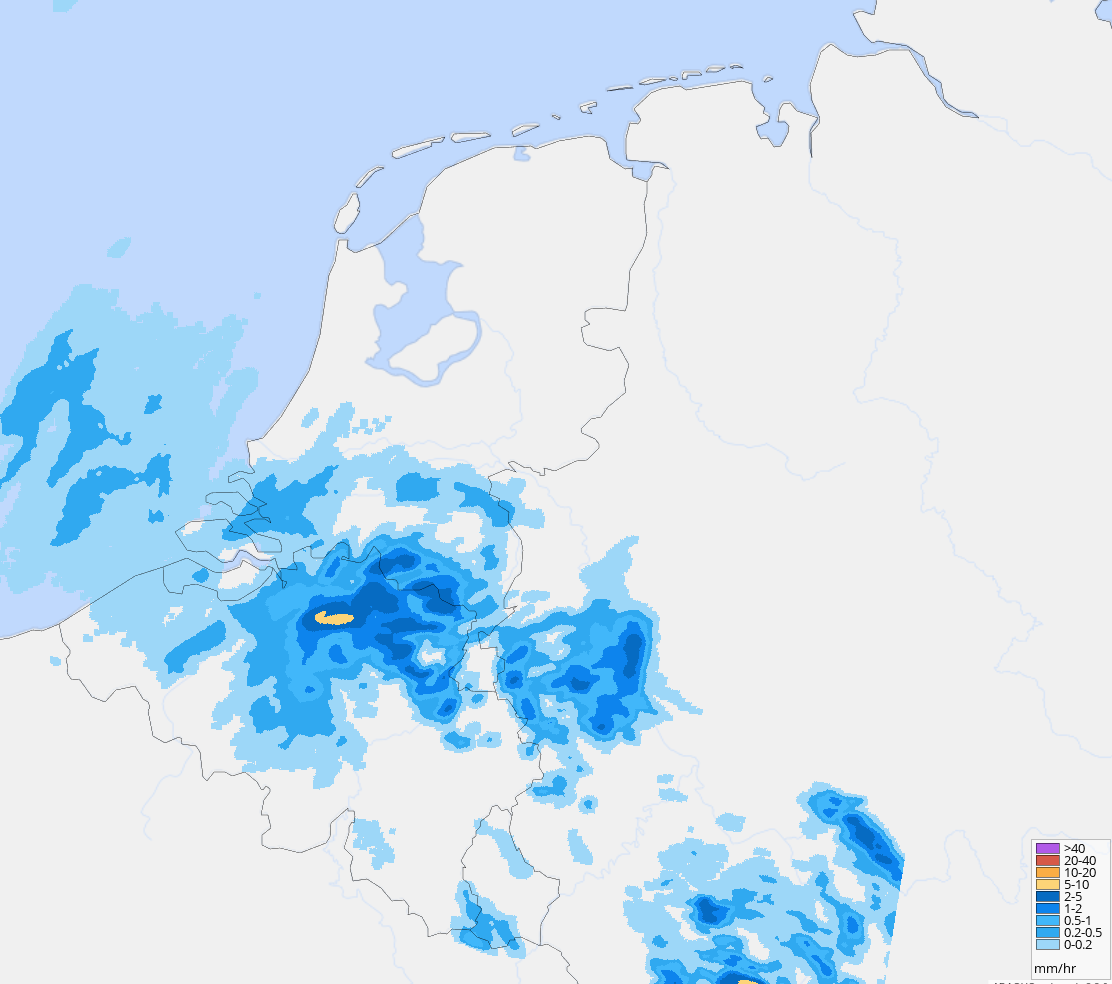

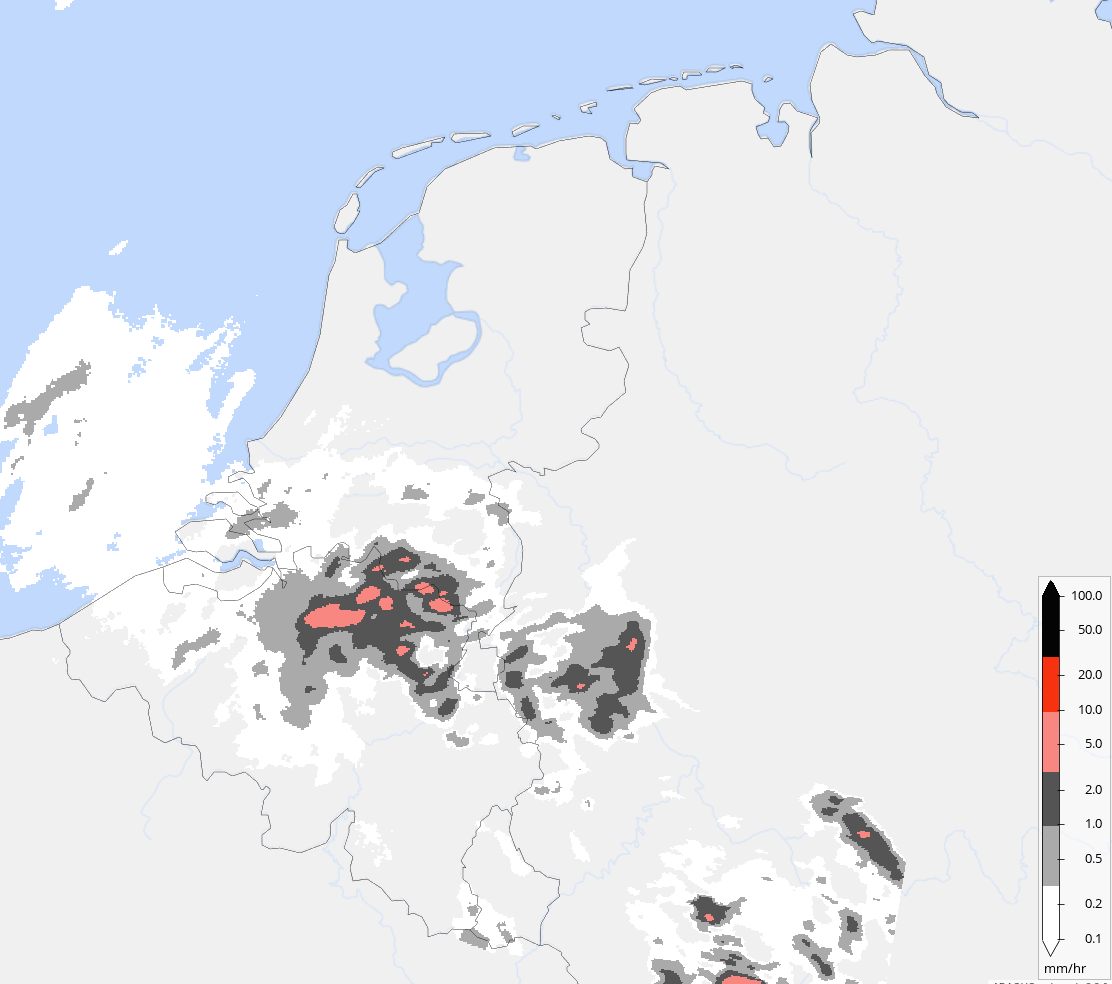

A pre-rendered image, generated from radar data, is fetched from the KNMI WMS API. This service does a lot of the heavy lifting, such as geographic projection on a map. But it also determines the colors of the image (the style).
The integration stitches a series of these images together to an animated gif. The radar datasets have two different styles available: a white/gray/red one and a blue/yellow/purple one. See a comparison below of the exact same moment.
As you can see, the color scale will lead to different contrast of different precipitation intensities. If you look at the legend, you’ll see the intervals for the different colors.
I had chosen the blue/yellow/purple one originally because it quite nicely matches the default home assistant style. I will see if I can make a dark mode using the white/gray/red color scale and a different background image. I’ve opened an issue for it.

I am in the same boat. My dashboard is in dark-mode (like most?) and would love to see a more dark-style precipitation radar

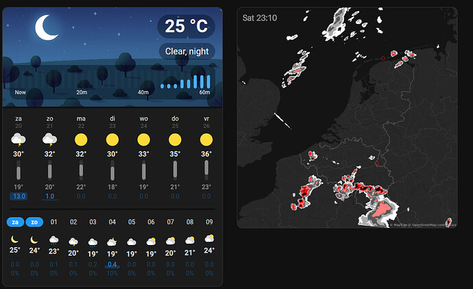

Here a screenshot of an initial version of a dark mode radar image. Still need to fix the colors of the text and location marker. And some more cleanups.
I’ve opened a PR for it here. You can test it out, if you’re brave. You can change to dark mode by using the gear icon on the integration config page.
i’ll give it a shot tonight or tomorrow
The dark mode radar works great for me (blends well in into my dashboard) also happy with the location marker. The text (day/time) is difficult to read.
Thanks for testing dark mode :slight_smile: I’ve updated the PR and changed the text color in dark mode, added translations and some more fixes. Think it should be mostly ready.

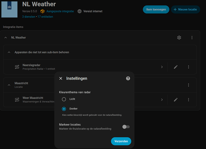

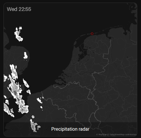

I’ve now released the dark mode radar theme in version 0.5.0..
This is it how it looks.
You can reach the settings from the gear icon in the integration:
