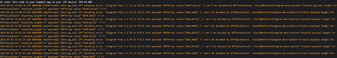

I keep getting this error message in the HA:
024-12-30 18:44:30.630 WARNING (MainThread) [xknx.ga_dpt] DPT decoding error. Telegram from 1.1.253 to 9/3/2 with payload <DPTArray value=“[0x0,0x32]” /> can't be decoded by DPTValue1Count: <CouldNotParseTelegram description=“Invalid payload length for DPTValue1Count” expected_length=“1” payload=“<DPTArray value=”[0x0,0x32]“ />”/>
This message appears regardless of whether I adjust the setpoint on the glass button or in the HA. If I read the address 9/3/2 in the group monitor, the same error message appears. But everything works.

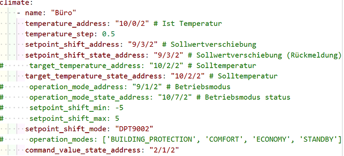

> climate:
> - name: “Office”
> temperature_address: “10/0/2” # Actual temperature
> temperature_step: 0.5
> setpoint_shift_address: “9/3/2” # Setpoint shift
> setpoint_shift_state_address: “9/3/2” # Setpoint shift (feedback)
> target_temperature_address: “10/2/2” # Setpoint temperature
> target_temperature_state_address: “10/2/2” # Setpoint temperature
> # operation_mode_address: “9/1/2” # Operating mode
> # operation_mode_state_address: “10/7/2” # Operating mode status
> # setpoint_shift_min: -5
> # setpoint_shift_max: 5
> setpoint_shift_mode: “DPT9002”
> # operation_modes: ['BUILDING_PROTECTION', 'COMFORT', 'ECONOMY', 'STANDBY']
> # command_value_state_address: “2/1/2

I have now only activated a few lines (red).
If I now increase or decrease the temperature on the switch, I get the error message again. If I change the temperature in the HA, no error message appears.
If I do not activate the line with #, no error message should be created, right?

Have you read the link above? This log message has nothing to do with any entity behaviour or yaml configuration. It points to a wrong DPT setting in your ETS project.
Yes, I think it comes from the KNX bus
Also, if your actuator works with setpoint shift, configure it accordingly, but omit target_temperature_address:.
You can either change the base target or the setpoint-shift value, not both.
This is what the log file says:
Exactly the same as above :person_shrugging:
I have now tried a few things again, but the message still appears.
