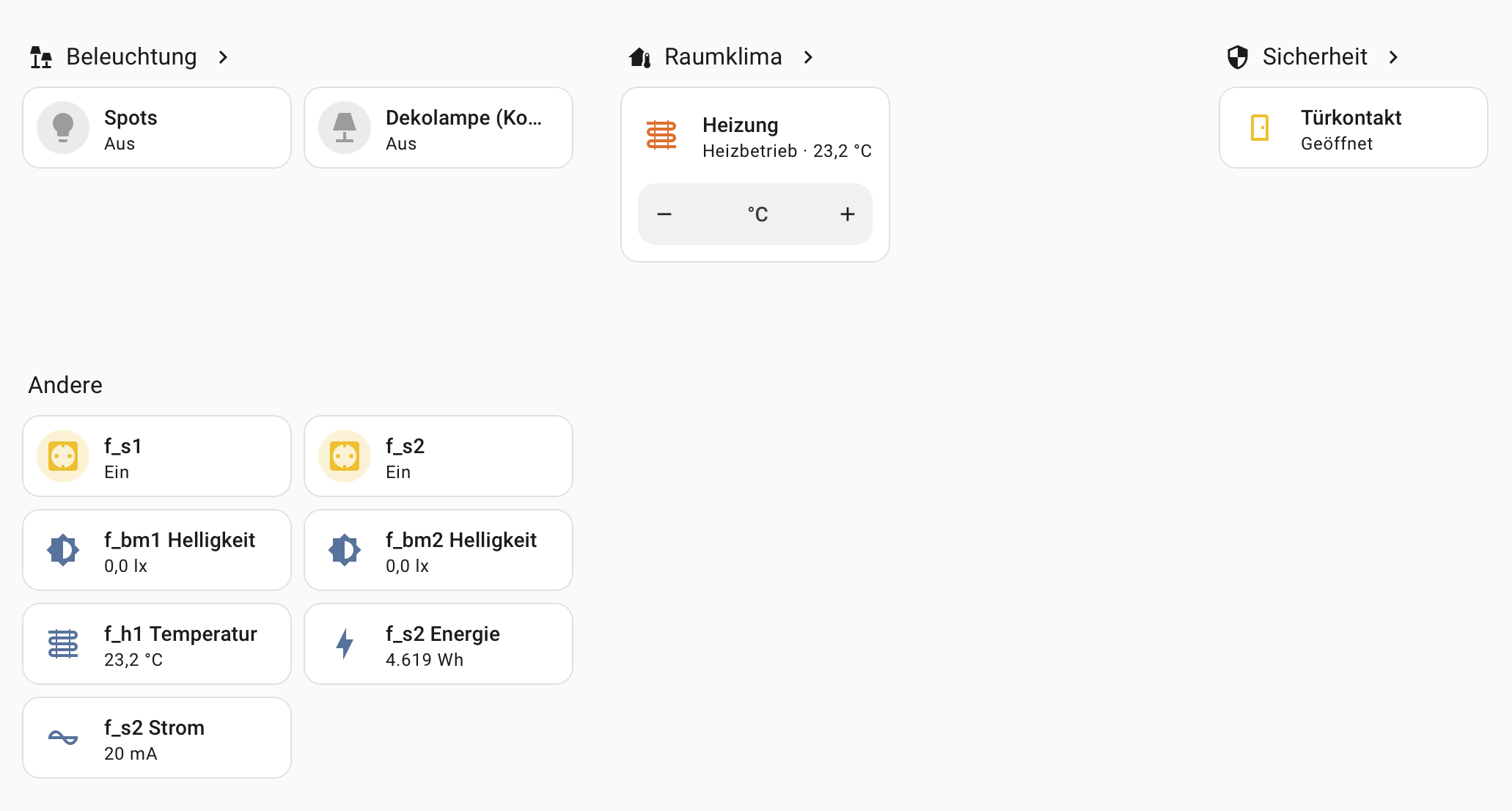

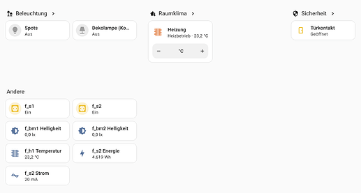

problem
The following screenshot from the dashboard however shows that the friendly name only works for lights, climate and door contacts (binary sensors), while it is ignored for sockets/outlet and other sensors.

The icon for this outlet changes. I also tried to use name: instead of friendly_name: or set friendly_name: directly in knx.yaml as an AI suggested to to so but it didn’t work as ist is wrong as far as I understood the documentation, so that’s no surprise. I can rename the from the UI but I don’t want that to keep my system in sync with my KNX setup (the YAML files mentioned) are generated with a script from my KNX planning tool and not written by hand).
question / expected behavior
How can I set the friendly name for all kinds of elements via YAML?
Bonus question: The sockets and sensors appear as “Andere” (others) in the dashboard, is there a way to have something like “Steckdosen” (outlets) and “Sensoren” (sensors) like it is done for “Beleuchtung” (lights)?

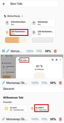

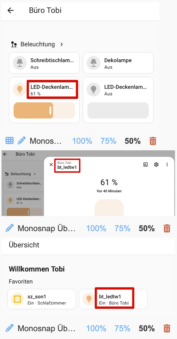

I also noticed the the friendly names of lamps are not used everywhere. For example at the overview for room “Büro Tobi” the lamp is shown as “LED-Deckenl…“. But in the dialogue and at the main dashboard in the favorites it isn’t.
