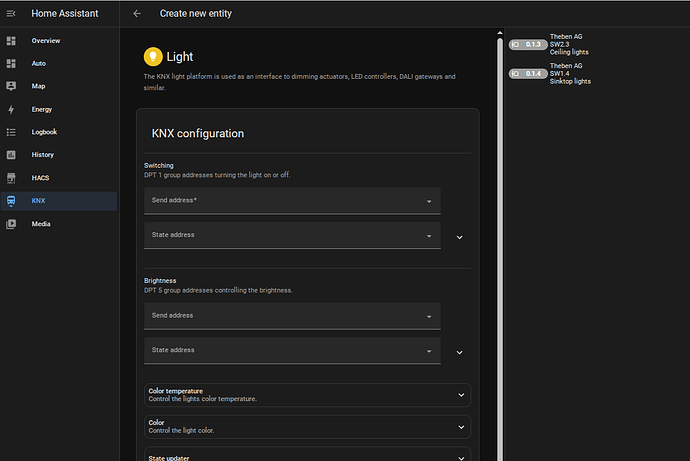

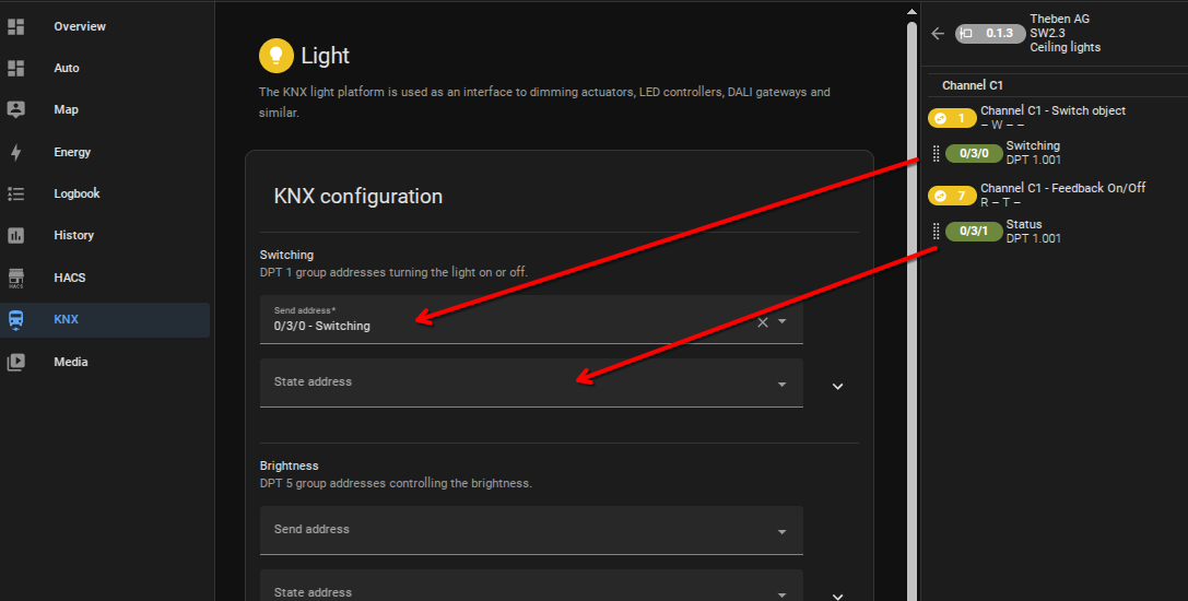

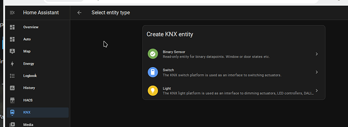

This is the dialog, opens from left side menu entry KNX. At the bottom is a big blue button “Add entity” and it gives three types to pick from (I need temperature, it’s none of those) and for example Light-type, there are project-file Devices that can be opened and underneath those Group Addresses can be dragged with mouse into new entity fields.
But yes, not automatically - but imo no knx.yaml is needed after that?
For the 3 platforms that are currently supported, you don’t need yaml config. You can use yaml, if you prefer, though. You can also mix if you like…
See KNX entities dashboard
