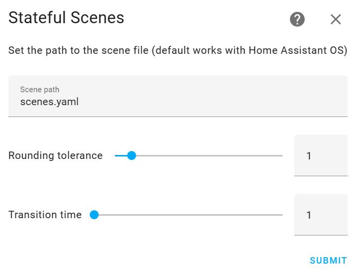

As I would also like to use the scenes in Apple HomeKit, I need to configure the “Stateful Scenes” add-on. However, the path to the scenes needs to be configured.
Can someone tell me the path for scenes configured via the KNX UI?

Thank you. There is no file path to reference?
No.
I don’t know what that addon is, but I guess it expects HA-created scenes, not scene entities of integrations.
