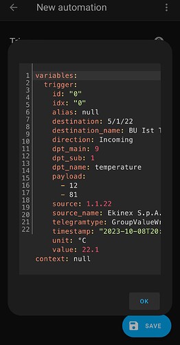

You can use templates to match the trigger object eg. in a condition.
Click the blue “Triggered” bar in the automation builder to see its values live when it fired.
