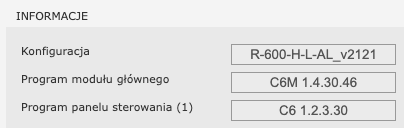

The issue might be the C6 firmware you are running. Komfovent are not very forthcoming with new firmware or the MODBUS document. I have both, just not had time to do anything with it.
What I know is they changed this and added a new mode.
I am running this firmware
I got confused with the results of my testing yesterday. I see that actually HA is able to retrieve operation mode information it is just it gets not all responses formatted in the same way. see the mode graph:
so I though what if I update the unit as maybe some performance issues would be fixed. Now I am on this version:
maybe not the wises move with the update though as Komfovent indeed is not doing well with the documentation either changelogs

hi - I’m stuck with this integration.
My ventilation is a Komfovent C6M, but I see I have a newer firmware:
INFORMATION
Configuration
R-450-V-R-AL_v2246
Main module firmware
C6M 1.4.33.51
Control panel firmware (1)
C6 1.1.3.34
Control panel firmware (2)
Based on the docu on README.md
this is what I did:
  • in configuration.yaml I added:
homeassistant:
  packages:
    komfovent: !include komfovent.yaml
I added the file https://github.com/borpin/ha_komfovent_config/blob/c8b06a3772b66f80d2305238bce36a215626ce0e/komfovent.yaml
I adapted the IP address (I’m using a fixed ip)
