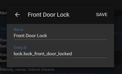

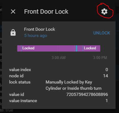

Did you rename your lock to lock.front_door_lock_locked
If not go to the <>
menu and edit the name:
I copied the code from earlier in this post (Kwikset 912) as a first step into figuring out HA - I’ve got zero experience with linux and or coding, so I may have bitten off more than I can chew.
That said - your pictures pointed out to me that I can change the name of the entities of the node and by default they were something like zwave.kwikset.a.bunch.of.other.things.
So I’m playing around with those. I now have the status fixed but I somehow broke the battery, so working on that. Appreciate the detailed info - it definitely pointed me in the right direction.

- Going to Configuration->Z-Wave->Z-Wave Node Management, there is apparently no way to set codes for the device. Lower down on the page, there are “Node Configuration Options”, but the primary parameters are 30 "User Code Type"s, rather than just User Codes. So…
Or maybe I’m just not understanding these messages. That very well could be the case. But the device isn’t responding to commands. That much is clear.
How many nodes do you have?
If you are unable to lock/unlock the device from HA, then the lock is either not paired through the add secure node process, or your network key is not set or malformed. You should not try and pair the lock manually with the stick disconnected. You should only pair it through the Zwave configuration page in HA.
