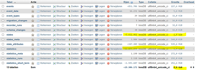

Large statistics database (1,9G, 40% of total DB)
Everywhere I read this table should not consume much space, and therefore is never cleaned-up. Long term history is stored forever. (Which is nice)
I have a quite large (and messy?) setup and the table is now 1.9 GB in size (that’s not small right, of the 4,8 in total). It contains 12.8 Million records. What is wrong here?
The states table was even worse but I started cleaning a lot, excluding lot from the recorder, disabled many entities, reduced update rates, etc… This table is now reduced from 4.4 GB (14.5M records) to 1.9GB (3.5 M records). I’m still cleaning and the recorder history/purge settings will clean this tables over time.
I removed many entities from the developer tools > statistics that didn’t have any states anymore, old, removed, etc. I can;t clean anything else from here.
However, the amount of records in this table is only slightly reduced from 13M to 12.8M.
How can I trim this statistics table (without removing important data)? Is there a way to figure out if there are some specific values overflowing this table?
I keep reading this table should be very small in size, 1,9 GB or about 40% of the total DB size is not small. So, I assume something is wrong?

The issue I face is that the statistics table can;t be reduced.

1.9GB (for only the statistics table) is a fact, so that is about 1,5MB per item. (doesn’t make sense)
(Total DB size = 4,5. No issues with auto purging “states” and “short_term stats”, understand that part. Cleaning up entities will reduce size eventually)
