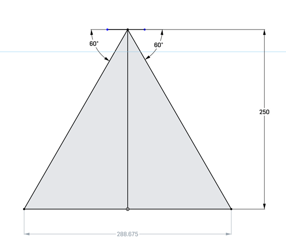

@anon66319504 @HLK-Annie @HLK-Stella can you provide a bit more info on the ranges? I’ve calculated that if the 2410C has a 60º degree angle and it’s at 2.5m in the ceiling it will be around 2.88m of detection range. Is this accurate? What about other sensors like the 2411S? It would be great to have that info on your website!

I agree. Viewing angle of the sensor is 60 percent as I know. You can even roughly test this if you move yourself more than 30 percent left or right of the viewing angle of the sensor. It will not detect presence.
