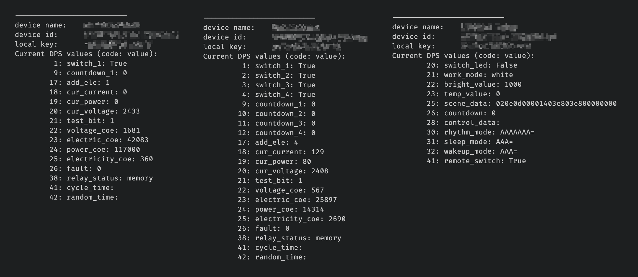

Previously I was using list tuya devices script (Revisions · List Tuya devices and local keys using OEM API (Ledvance or generic) · GitHub)
But now it turns out I can see local key and device id/virtual id in Smart+ app and I can simply use in tuya local integration.
Figured out to write it here as maybe someone will find it usefull on how to integrate in tuya local.
I updated the python script GitHub - omBratteng/ha-ledvance-tuya-resync-localkey: pyscript for homeassistant to resync local keys from private tuya api so that it prints the DP ID, schema code (easier to identify what the ID is for) and the DP value
TYVM for sharing, indeed worked for me too
Not sure why, but the script doesn’t show up if I try it with pyscript, but running it on my PC with python works like a charm.
