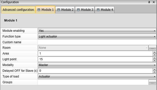

1/ Huum interesting…do you mean the wallswitch to turn on the light could not be a switch WHO 1 LIGHT but WHO 1 SWITCH ? Or an automation? So i should try the apl with those Whos ?
2/ Let s take this singlewall switch that is for only One light/bulb. How come it has 4 modules ?
It it normal ? knowing module 1 and 3 have same APL could it be the “bug” ?
I meant that maybe the light that you thought to be A=1 PL=13 is actually not that. Indeed if you have a scenario module, that command could trigger a scenario that in turn switches the light on. That would be visible as the “function type” of your command being something like CEN or CEN+ maybe
When you have an actuator/command, you have both devices in one, you have the command (which is the buttons you press) and the actuator (which is the relays behind the buttons) in one package.
If you use physical configuration the commands will always match the actuator, but if you use the virtual configuration mode, you have more flexibility.
Modules 1 and 2 are the actuators, module 3 and 4 are the commands.
If you wish to, you could configure a wall button to not control the actuator right behind it but something else entirely (I’ve done that in a few places in my home)
However, the default is to be the same; i.e. module 3 (left button) controls module 1 (left relay)

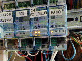

So i did many tests and understood almost fully how the bus is configured.
I found another bus install that is linked with the F454 since these items show in MyHome Suite.
But these have leds blinking as on video here :
Even though i found all the correct APL of the correct Actuators, i still have that problem : The HA switches get the correct state but i am unable to turn on or off the switch the light from HA
I wonder how i can be helped …
Do you mean you have multiple busses in your installation? Linked by an F422 or something similar?
I have a mainboard where the F454 is and yes There seems to be indeed a F422 but on the mainboard.
And i have another board (that is in another part of the house) that is linked to the mainboard (F454) with 2 devices on error (outdoor lights but i dont mind these)
