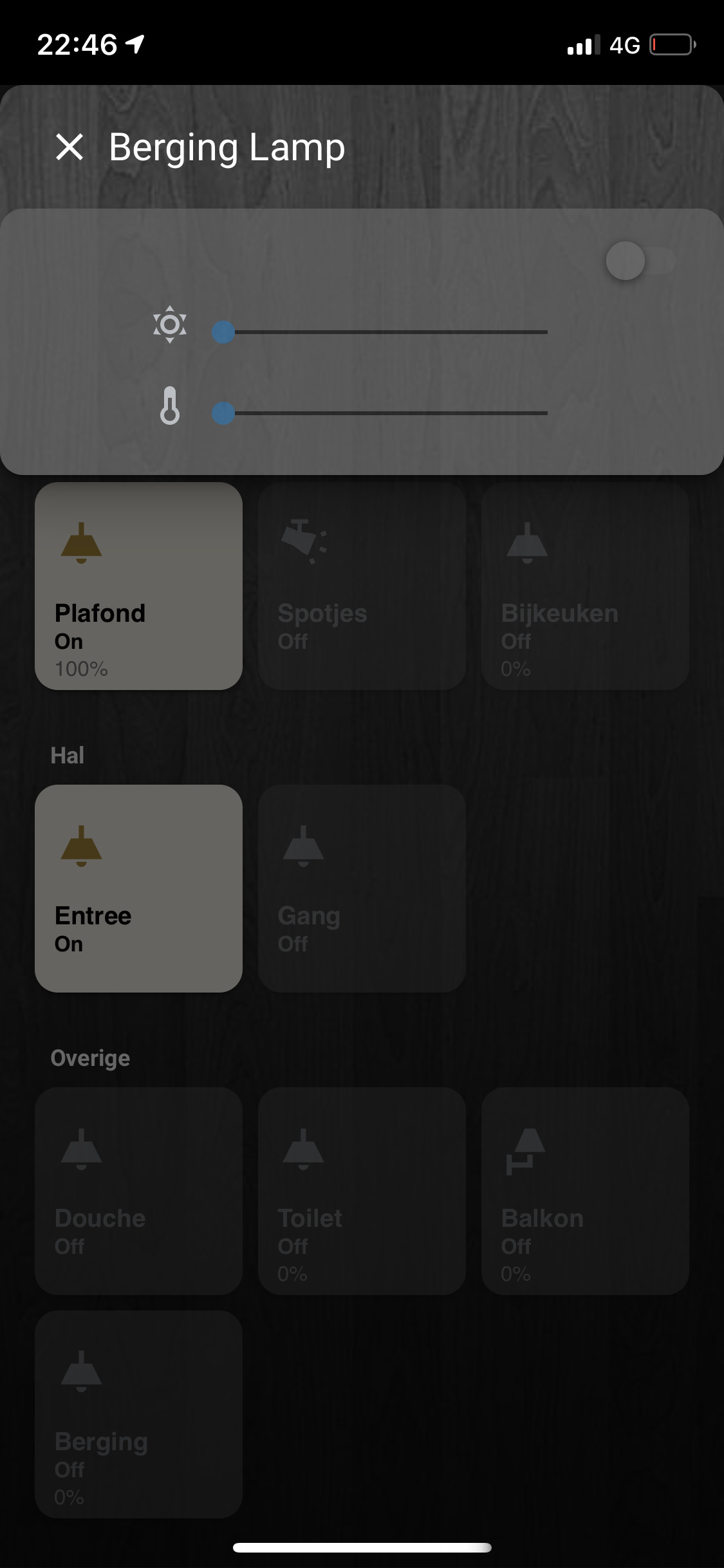

I use this card too, but what I would really love to see is a vertical slider type (and maybe a bigger slider knob). That would make this card even better. I use them in popup cards with the new 3d touch mod. So a vertical slider would make it even more Apple style.
This is what I currently made of it.
