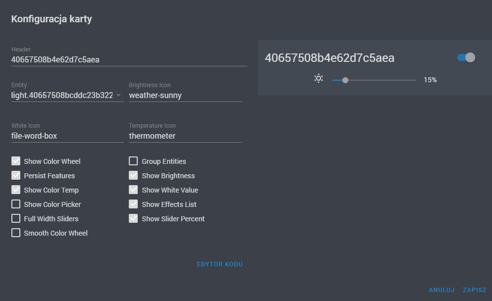

Hello all! Has anyone had any issues with the color wheel not showing up? The card installed properly (seemingly), however I have no wheel. I have ensured the config is set to true, restarted HA multiple times, even reinstalled the plugin.
The brightness slider works, but that’s about it. Thanks in advance if someone can point me in the right direction.
what lights are you running? if tuya based then yes, no color wheel. have to flash the lights with tasmota or esphome to get it back since the light.py is broken for tuya at the moment… if not tuya based. sorry not sure.
Here are some fixes for your issue. Just a little warning, because I don’t know how tech savvy you are.
IF you mess up, you have to install Home Assistant Core (previously called Hom-Assistant) again.
They are indeed Tuya based, that explains it, thanks for the info!
It didn’twork
tuya RGBW bulbs, HA 0.107.5 (now updated to 0.107.7 and still didnt work)
I see only one slider without colour wheel picker

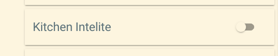

Hi everyone! I wonder if this card works with any ha light entity (like for example template light entity)?
Using Hassio v0.109.2.
I have and IR controlled Intelite lamp which allows to control the light temperature and intensity, but for some reason I do not see any controls other then on/off switch:
Here is my light setup (it’s a work in progress so still figuring out how to set up the controls for T and brightness):
input_boolean:
kitchen_intelite:
initial: off
input_number:
kitchen_intelite_brightness:
name: Kitchen Intelite Brightness
unit_of_measurement: '%'
min: 20.00
max: 100.00
step: 4.44
initial: 100.00
kitchen_intelite_temperature:
name: Kitchen Intelite Temperature
unit_of_measurement: 'K'
min: 3000.00
max: 5600.00
step: 288.89
initial: 3000.00
light:
- platform: template
lights:
kitchen_intelite:
icon_template: mdi:ceiling-light
friendly_name: Kitchen Intelite
level_template: "{{ states('input_number.kitchen_intelite_brightness') }}"
value_template: "{{ is_state('input_boolean.kitchen_intelite', 'on') }}"
temperature_template: "{{ states('input_number.kitchen_intelite_temperature') }}"
turn_on:
- condition: state
entity_id: input_boolean.kitchen_intelite
state: 'off'
- service: input_boolean.toggle
- service: remote.send_command
entity_id: remote.kitchen_rm_mini3
device: intelite
command: noon_mode
turn_off:
- condition: state
state: 'on'
device: intelite
command: turn_off
and my ui-lovelace.yml:
ards:
- type: vertical-stack
title: Kitchen Controls
cards:
- type: custom:light-entity-card
entity: light.kitchen_intelite
color_wheel: false
group: false
brightness: true
color_temp: true
I would love to have the ability to control the light temperature and brightness in UI.
