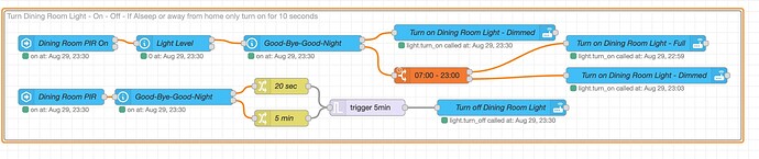

So i have this flow. If motion is detected and the light level is less than 1000. Then are we in bed or not at home. If we are in bed and motion is detected it turns the light on for 10 seconds and then it turns the lights off. Works great if you are just passing through the room. However i have the same work flow for our bathroom. Mrs is getting the hump because after 10 seconds the lights go out and even through there is movement in the room the light is not turning back on again. Any suggestions to improve this flow?

Thanks mate. I have pissed around with this so much. Right now this is what i have.
Basically on the top item “Turn on Dining Room Light - Dimmed” i am trying to get the light to turn off after 10 or 20 seconds but stay on if motion. The 07:00 to 23:00 branch the light can turn off after 5 mins as normal.

Thanks mate. So the light is turning on but is still turning off with motion in the room and its not waiting 5 mins
I only need the light to go off after 20 seconds say if the Good-Bye-Good-Night toggle is on. Out side of that the light can stay on for 5 minutes before going off with no motion.
Below is my updated flow based on your changes.

Delay is overridden by msg.delay in milliseconds. I set the 20 sec delay to 10000 mls because it’s 10 seconds from the PIR blind time plus 10 more seconds.
Ok so we are getting close i think. So when Good-Bye-Good-Night is off the light is coming on and staying on for 5 minutes.
When Good-Bye-Good-Night is on the light is coming on and going off after 20 seconds even though there is motion in the room. I have / will be using the same flows for other rooms. The bathroom is the one my Mrs is giving me a head ache over. :slight_smile:
Any other suggestions? Not far off it

sorry mate, I’m lost. Trigger node is behaving as expected according to my tests… I dunno where the problem is.
Just looking at the picture of the flow you have posted - what is different between the top and the bottom stream ? They both look like they are going to be operating on the PIR in the dining room - are you sure these are not running in parallel and clobbering each other ?
Maybe put some debug nodes on each one and set it to the full debug message (and give them both names like top and bottom) and post up the debug screen when you force motion

I think this seems to be working. I recreated manually what you did rather than import as i think something odd happened when it imported the flow. I also changed the off section to the off connection on the PIR @craigcurtin it might just have been that and thank you for the nudge in the right direction.
I need to do some testing. When the Good-Bye-Good-Night is on the light is switching off after 30 seconds. which i think you said was the 20 seconds delay and 10 seconds from the PIR blind time. 30 Seconds is more than fine.

I don’t think this last picture you posted will work since the trigger node relies both on the on and off state to start / stop the countdown.
I don’t think top and bottom flows are clobbering, I would try to merge them though… not sure it would be worth it.
Mikefila’s suggestion is the best / most compact / prettiest solution you’ll find. If that doesn’t work, problem is somewhere else.
He made a little mistake in the Jsonata delay, he forgot to add the " = ‘on’ " comparison. Put this instead, but as I said, it’s the best approach we’ve come up with in this thread:
$entities('input_boolean.good_night_good_bye').state = 'on' ? 20 : 300
