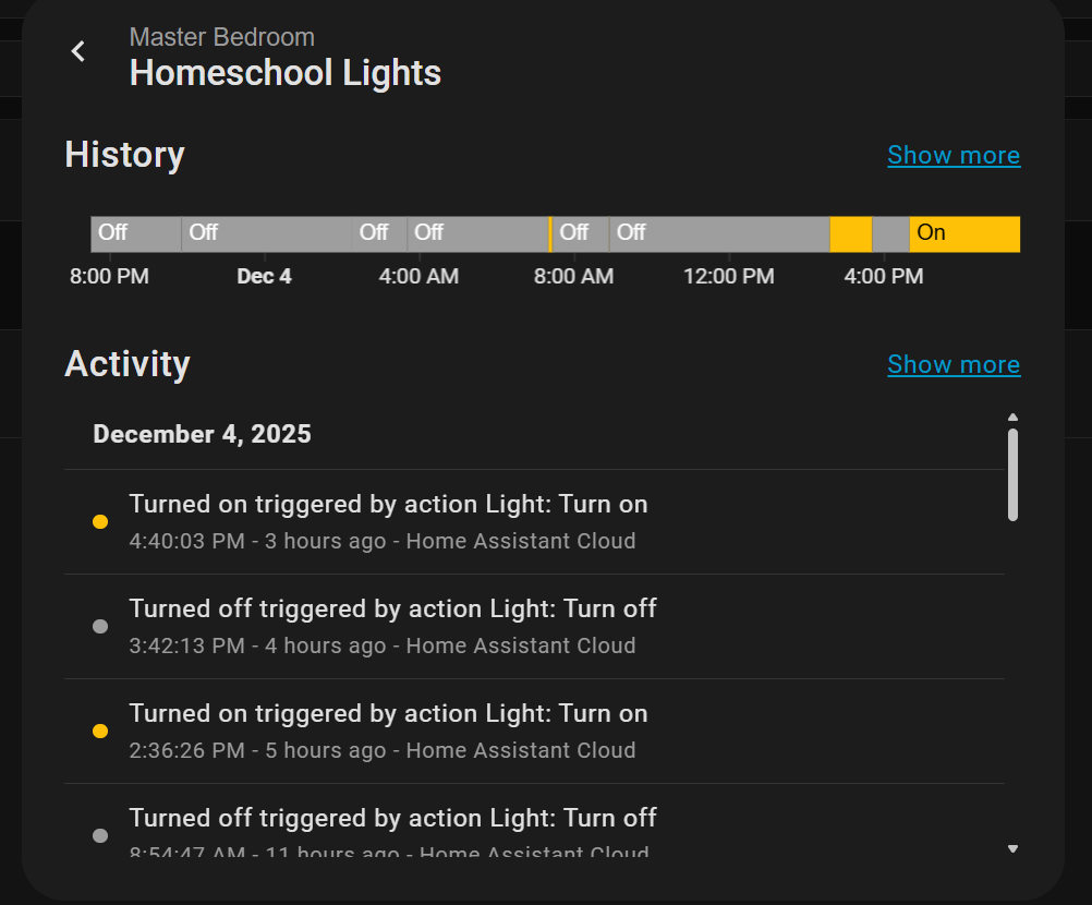

I have a weird issue where one group of lights keeps randomly getting turned on throughout the day. It’s the worst at night, so I created an automation to automatically turn them back off, so we can sleep.

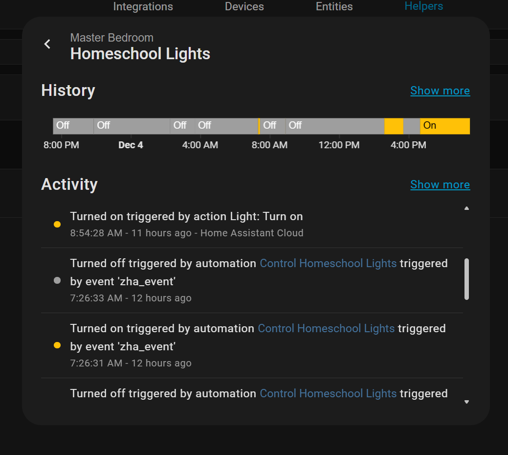

I even disabled my automation, and it kept happening. I swapped the button, lights, etc.
It’s been happening for 6 months now, but I noticed the latest Home Assistant is finally giving me some better debugging:
Notice how you can see it says “Home Assistant Cloud”? Why is “Home Assistant Cloud” randomly deciding to turn my lights on at odd hours?

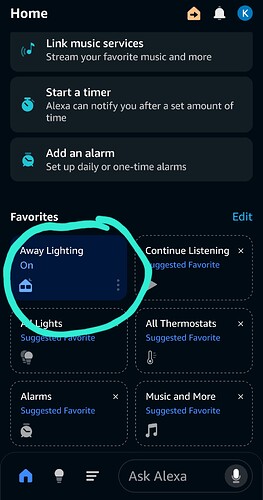

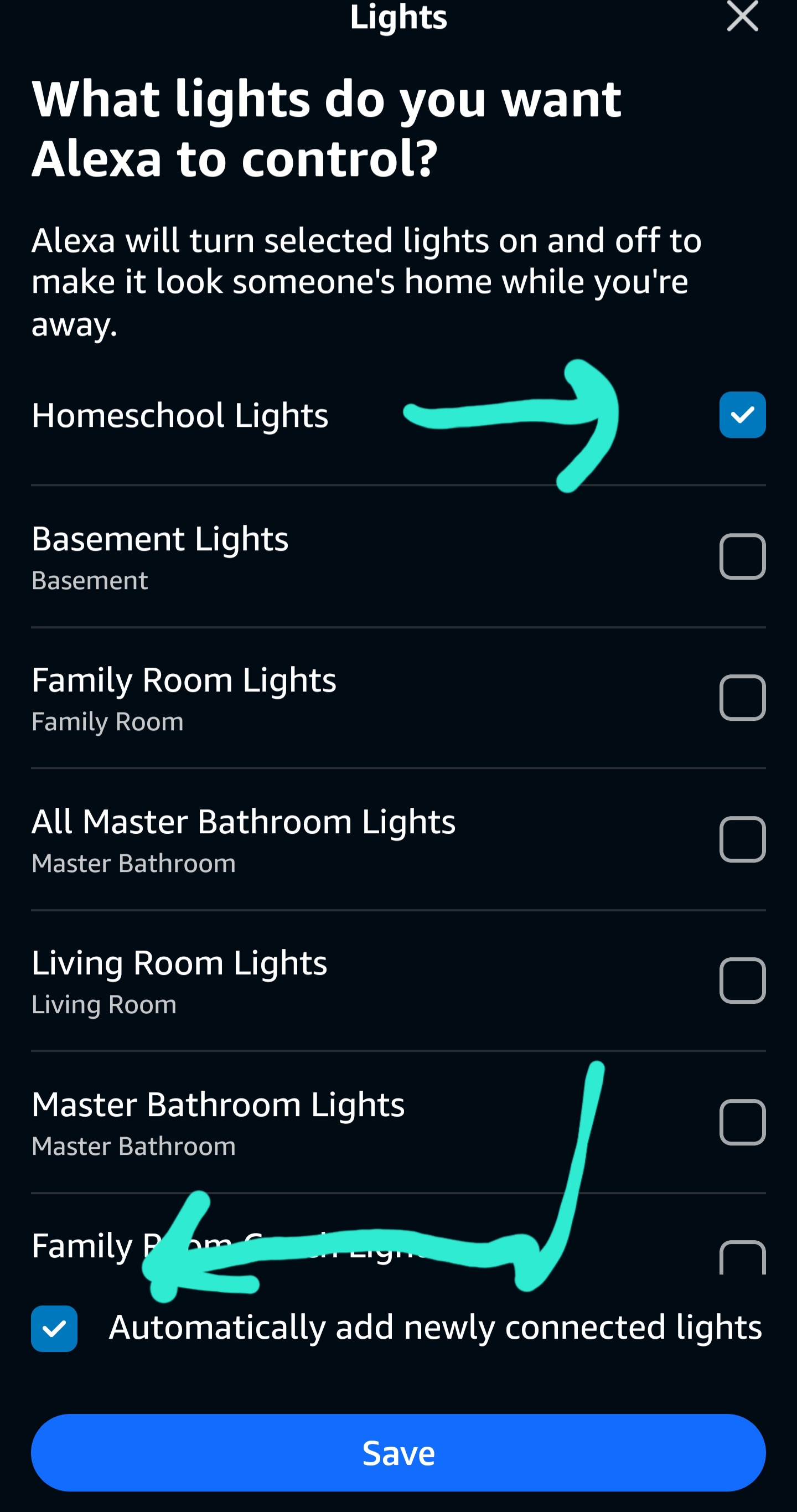

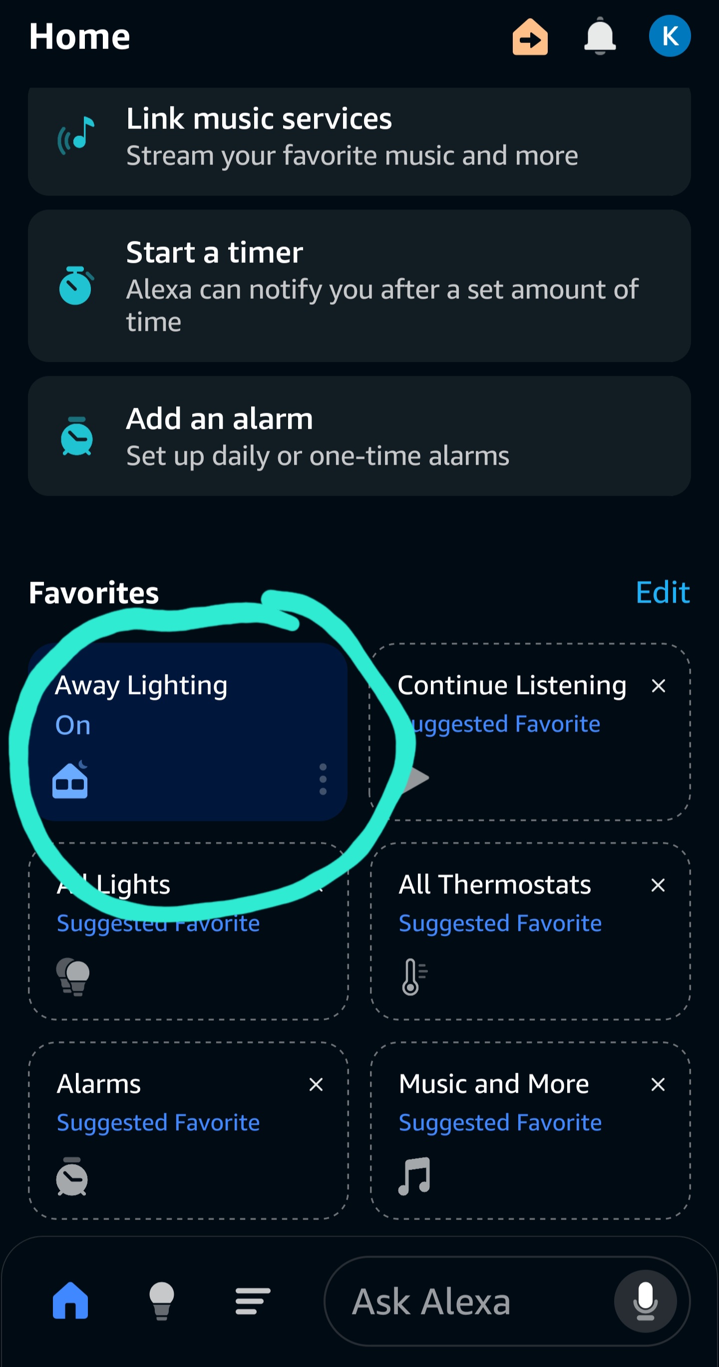

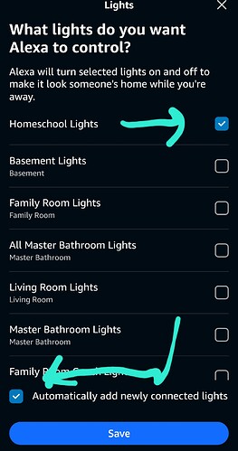

Yep! Alexa turned out to be the issue:
I also deleted the “Modes” thing in Alexa and any other automations it created. I don’t like it trying to randomly determine if someone was here or not.
I do everything in Home Assistant, so I’m not sure when or how this got turned on. Alexa hears random things all the time.
