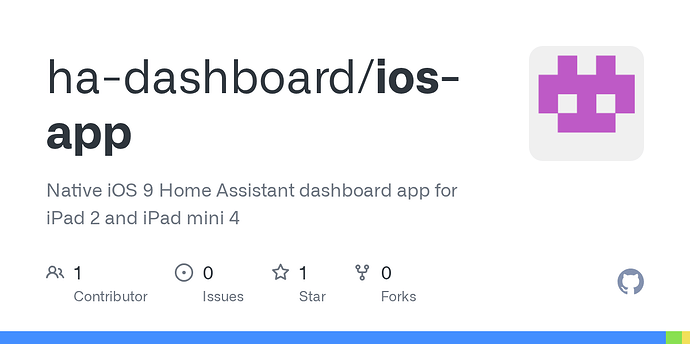

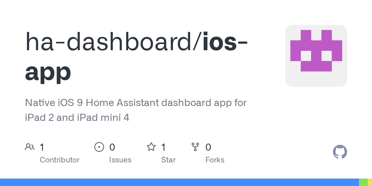

If anyone is still interested in this. I’m using HA Dashboard. I posted a photo of my setup here. It’s been working well for the last few years
Would you mind explaining this setup in a little more details please?
Hi @maddoglee , can you provide me more details? I’ve also an old iPad 2 and would like to have something similar
I am here wondering exactly this.
I have an old iPad and it is next to useless. Kids cant even do their homework on it.
Thought it would be perfect for a dashboard…
But the iOS browser limit is the killer.
It is borderline criminal that Apple lock the browser engine and then refuse to update it…
THINK OF THE eWaste!!

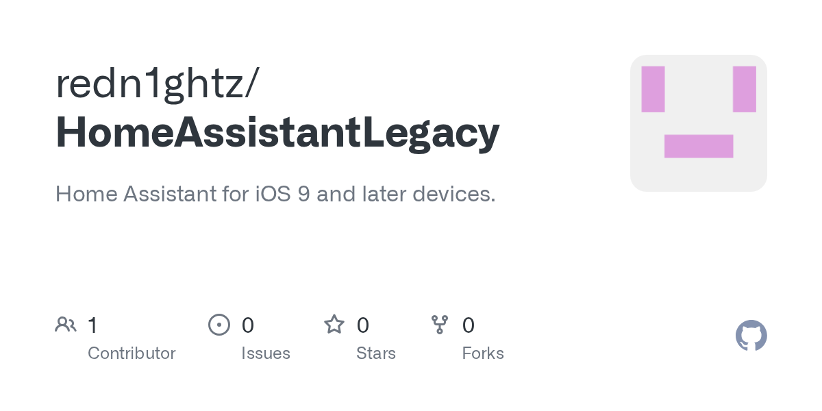

This is the solution, works with iOS 9 and later, natively!
I also created an app for iOS 9 and later. Maybe it will be useful to someone.
