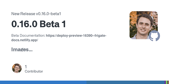

the new frigate 0.16.0 Beta 1 has a licence plate build in now:
So perhaps, this could be an alternative.

Anyone know if the licesnse detection in Frigate 0.16 Beta is better? I had ChatGpt
TRY to help me set up an automation to take 5 snapshots and analyze them but place recognizer won’t allow quick succession submissions (according to ChatGPT) and spacing them 1 second apart took about 12 seconds to analyze all 5. Hopefully (if 0.16 does this locally) it will have the ability to analyze multiples faster and more reliably
All details on frigate are in the linked in the extra setup page:
If you have the 0.16 beta you can try it, all is done locally. I have no cameras for this use case, but enabled it, the cars are to fast to catch here :slight_smile:
I installed 16.0 beta. Facial rec seems pretty accurate so far - still training, but it’s pretty much just my mug around here LOL. Lpr is buggy - maybe my cams aren’t fast enough too. I upped my detect fps a little on 3 cams but didn’t have much effect. Using HAOS so can’t get hw accel to work with Intel iGPU. Not sure that would help anyway. Planning on getting a Frigate+ subscription; I hear it will help Lpr. Worth a shot and it helps support the awesome developers. Thanks for the direct.
