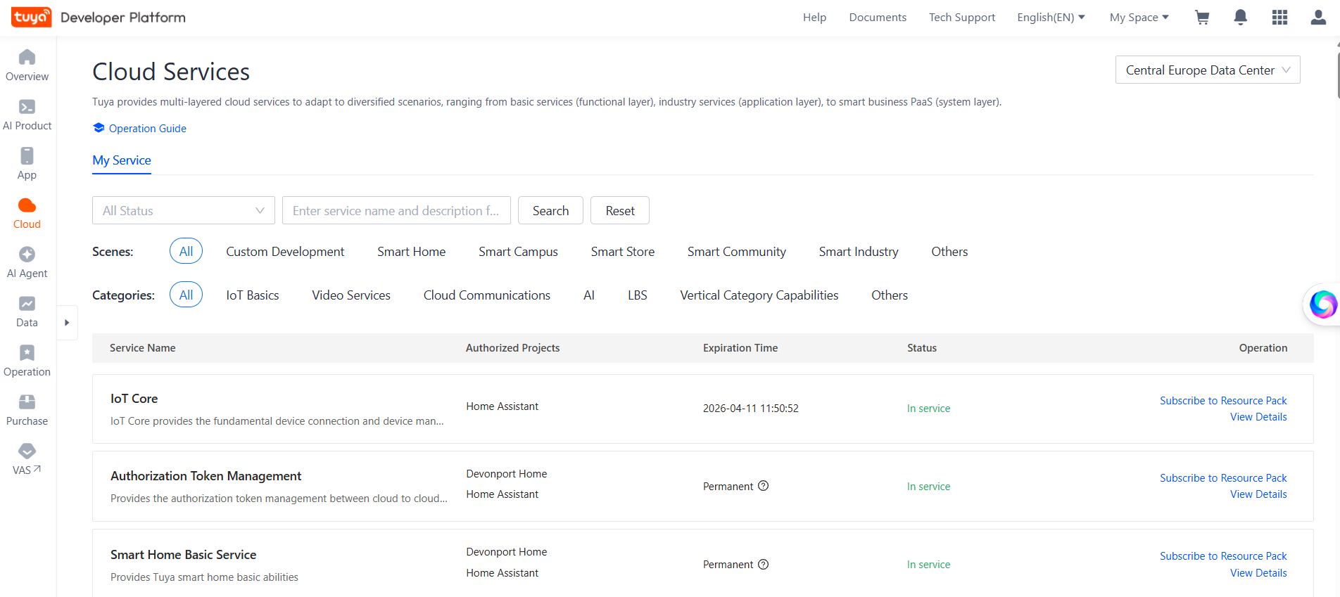

[az1…Fhp] Cloud API connection failed: Error 28841002: No permissions. Your subscription to cloud development plan has expired.
Except when I go to the tuya developer site everything seems fine.
Cloud> Cloud Services>
Check for expired subscriptions, there should be an extend for free option there somewhere.

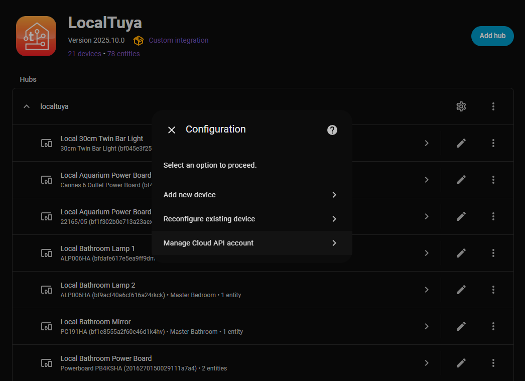

If not maybe try re-enter your Authorisation Key.
Cloud> Project Management> Open Project> Overview or Authorization.
Re-Enter these details into the Local Tuya Integration. Manage Cloud API account

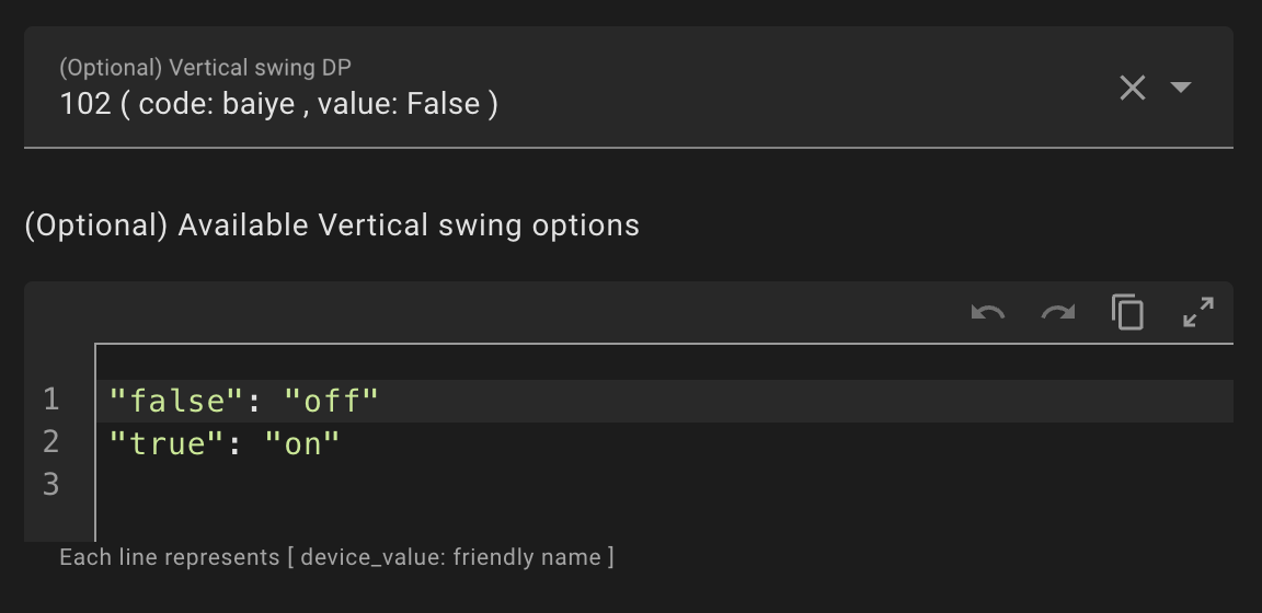

Hi, I’m trying to add the vertical swing control into the climate entity of the wall mounted heater, but the configuration device_name:friendly_name of the (Optional) Vertical swing options didn’t work for my device
As you can see, the DP wants a boolean value, but when i try to set the integration, it automatically changed the config in this way
And the control doesn’t work, how can I resolve this?

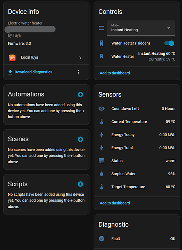

I’d like to share my template for HTW Water Heater if anyone needs.
I wanted to put this on the repo, but I did not find any appropriate location…so for now, I will share it here for those who come after

Homeassistant
With this template, you’ll end up with something like this:
